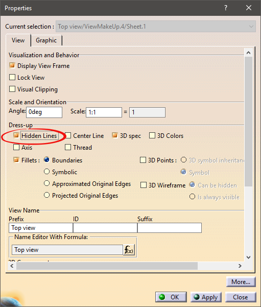

Hello,
I've started using Catia quite recently. I've made a part that I would like to dimension in 2D drafting, but the holes that I have made are not showing on the side of my part. They're supposed to be 0.5'' holes, but it looks like they're just on the surface because I see no depth when looking at it from the front or the right view.
Can anyone help me? I would appreciate any help!
Thank you!
RE: Through-holes not showing up in side of drawing CATIA
make sure the hidden line option is activated.
select your view, right click, properties :
Eric's post will be your solution.
Additionally, you have 3 Front views, make one view from 3d then project new views from that view. Your views will then be aligned and have more appropriate names.
Thank you very much!! Saved me a lot of headache.
