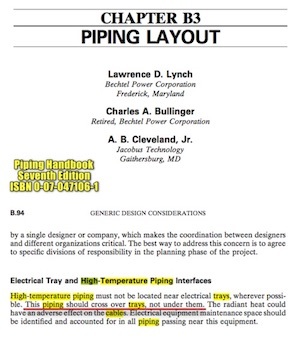

Which is the better practice in the event that piping must cross cable trays?
Is it dependent upon the pipe joining method or insulation? If there's a chance of leakage I would think that routing the pipe under the cable trays would be better. But...
Does the radiant heat from piping impact routing underneath cable trays?
This is just a general question because I came across another piece of literature that I wanted to investigate further.

Piping handbook referred to high temperature piping being routed over cable trays because the radiant heat could have an adverse effect on the cables.

What 'piping handbook' are you referring to?
Radiant heat does not just go up.
RE: Route piping over or under cable trays?
Piping Handbook 7th Edition - Nayyar
I agree with routing pipe under cable trays not over. Just when I read something like that in a published book, I like to get second opinions to back me up.
