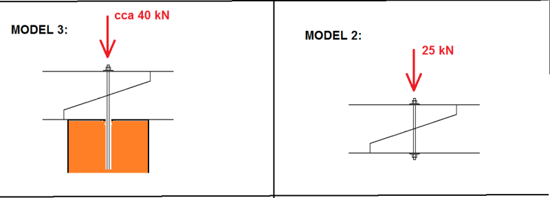

Hi, I have a question about connecting timber roof beams.
Since its pretty common, that roof beam consists from more than 1 element (span of several meters) we have to connect its elements.

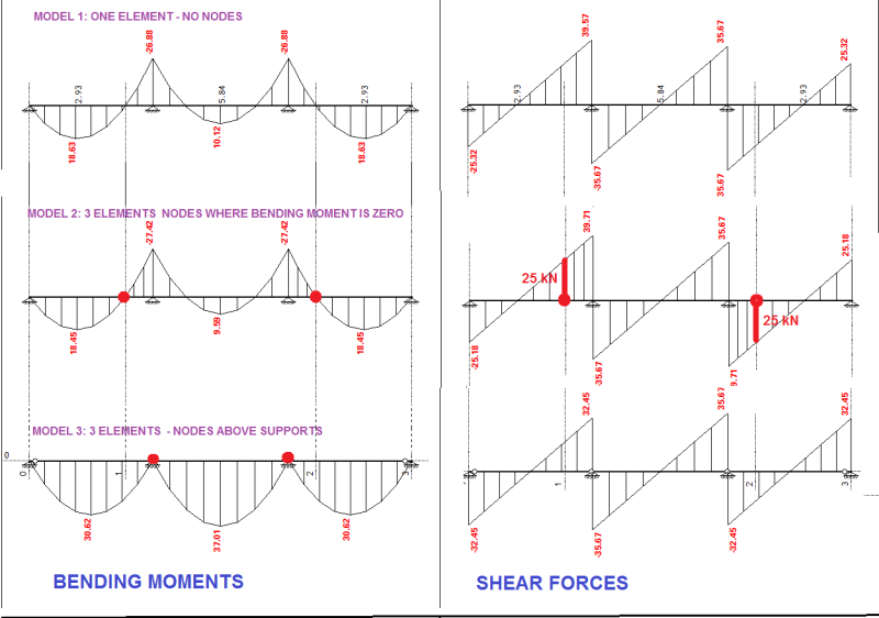

So if we have 3 elements we can connect them at/above supports (walls/columns)- MODEL 3 in picture. Other option is to make a connection at a point where bending moment diagram is zero - MODEL 2 in picture.
I found out that in MODEL 3 there are always bigger deflections which often causes problems and demands bigger beams. MODEL 2 has much lesser deflections at same load and geometry...
But what Im wondering about is what do we do about shear forces that acts AT connection (node) in MODEL 2?
How do we control it on shear force? in picture we have a shear force of 25 kN there...Element is 20/24 cm, timber C24.
I have never seen any project where engineer made a control of connection like this for a shear force. Why is that?

Unless you can get one piece long enough for continuous spans, we typically design wood beams as simply supported. So your model 3, but not normally connected that way.

Take a look at a few good Wood/Timber Design textbooks or other reference materials for wood construction. What details and arrangements do you see being used out in the real world, have you ever looked, studied, thought about what you see? Which model gives you the smallest beam sizes, the lowest stresses and deflections for a given loading and span arrangement? Model 2 is a fairly common framing model because is gives shorter beam lengths, smaller beam sizes, fairly clean connection details and clean construction/erection. I’ve seen the connection detail you show, but I would not normally use it either.
RE: connection of timber beams - shear force?

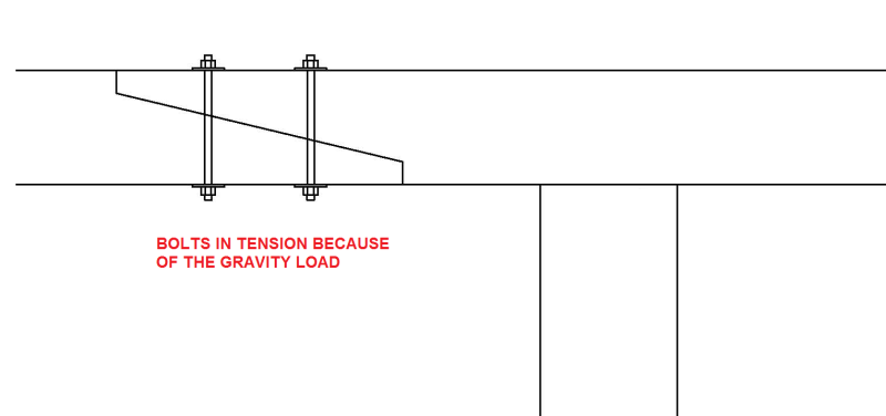

This is typical connection in my area. You turn your connection in a way that the bolt is under tension. Turn it around and you can get splitting in both timber members. So basically you need to design the bolt and the washer so it is big enough based on compression resistance perpendicular to grain. Most of the time there are two bolts.
Edit: I'm describing model 2. I design such connections. Maybe because I am more of a wood guy. Other engineers that mostly do concrete probably don't go in so much trouble and let the carpenter do his thing.

With the bolts in tension due to gravity loading, the drop in span has to be lifted into place, rather than "dropping in". If I designed it and detailed it that way, I'm sure the builder would get it wrong. I understand why the wood would split, but consider this detail archaic.

You might try "model 4" which would be similar to Model 2. To state the obvious, model two is a double cantilever with a simply supported beam on each end. You state that you've put the location of the connection "a point where bending moment diagram is zero," but in reality any location you choose for this connection will be a point of zero moment. So, you can tweak the length of the cantilevers so that the members will have manageable lengths.
I agree with msquared that a steel hanger would probably be less expensive, but if you choose to use a scarf joint, then I'd agree with hokie66 that the cantilevered end should be the lower piece. Then the reaction of the simply supported beam is transferred through bearing. Search images "timber scarf joint design" and you'll see some configurations.

To clarify, I did not say the cantilevered beam should be the lower piece. I was agreeing with molibden that splitting can occur with that arrangement, but the contractor wouldn't like his way.
hokie66, I did a lot of roofs with this detail. Some contractors just ignore it, but most of them want to do it right when I clarify the theory behind it. Erection is not so different because all of them use cranes, they crane the longer piece from side under the cantilever part and bolt it right away with crane holding it in position. Beams are light and there is no problem whatsoever.

Seems if the cant. end was the upper piece, it would be less likely to split as the notches would be in compression.

I see your point. I'll also add that some folks have done testing to try to determine the bending capacity of a scarf joint, so not everyone is assuming it's a hinge as I suggested.

Exactly the point which molibden made, and I agree.

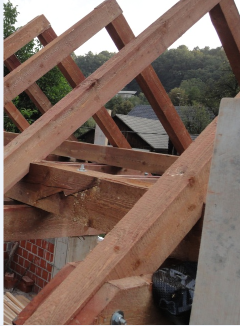

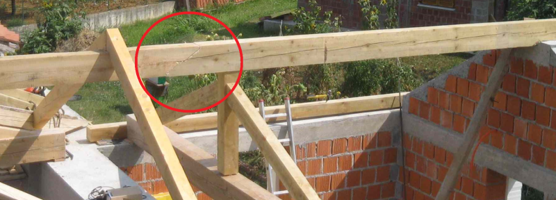

Read some Timber engineering books, some German ones have exactly this connection as an example. You can see the splitting of timber in your second picture under zero load. You can imagine what follows under extreme load. It works either way but do you want to have a weak connection in your structure? If the loads are low it doesn't really matter how you connect it...
Your second picture illustrates a point I made earlier. Using this detail, sooner of later a builder will get it reversed, unless properly supervised.

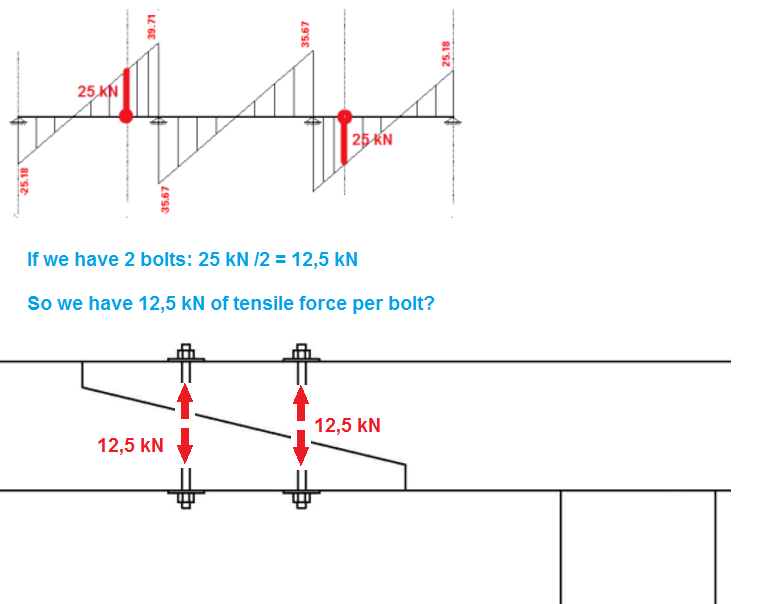

@molibden - you said you designed many joints like this.
My question: is a tensile force (shear force from diagram)in bolts the only force you consider when designing a joint? Any other controlls you make beside contact pressures perpendicular to the grain flow (washers)?

Fascinating thread. It seems to me that, installed snug, these connections would transfer quite a bit of unintended moment, resulting in the tendency for splitting in one or the other of the members. Is any consideration given to that in the design of these joints? Or does wood shrinkage introduce a bit of slack? Things always look pretty tight in the photos.
Is the second picture actually splits? It seems unlikely that under just self weight that it would split to that extent. They kind of look like surface shakes/checks and may just be a poorly graded piece of lumber.

In my opinion, no. I think that what the second photo shows is checks in the timber. This shouldn't be confused with horizontal shear failure that you can get in a loaded member if you don't account for notches in wood.
