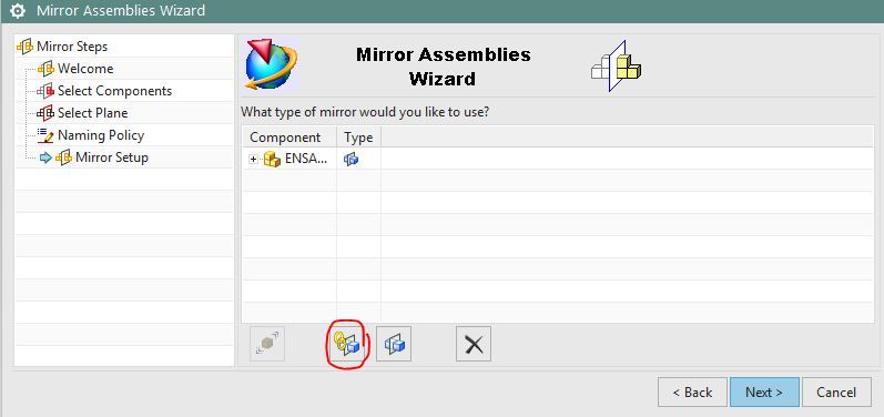

I have a part with a job number, the next job number is the same assembly but the main part is the mirror of the first one so I want to create a new part in a different folder and that part will be the mirror of the first one. So far I have tried mirror assembly but it doesnt create a different part in the other folder it just creates a mirror part in the first assembly and I can't modify the features of that part.
Is what I am asking possible?

Hi pllmoreau,
When you create a mirror assembly you have three options:
- reuse and reposition (not create new files)
- create a non associative part
- create an associative part
With the last one you will create a new file which contains a linked body to the original.
Are using the first one?? reuse and reposition?

Hello I am not using the first one, I used the non-associative link, my question was more if it was possible to have a mirrored part the way you clone a part, with all the features instead of working with links to the first part.

No, at least there is no automated way to do it. You can, of course, build the mirror part manually with all the features mirrored w.r.t. the first part.

What I understand is that you want a mirrored part with all the features (not just a linked body), but with these features creating a mirror body....Is what you want?
If it´s that...sadly, there is no possibilty.
