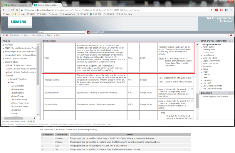

RE: BlockStyler - Enumeration Block
I was talking about setting the default option in Radio Box.
Regarding the items in Radio Box, the documentation says 'You can change the list of options after initialization only if presentation style is set to Option Menu'
Suresh
www.technisites.com.au
See Attached screenshot of the NX 11 documentation
