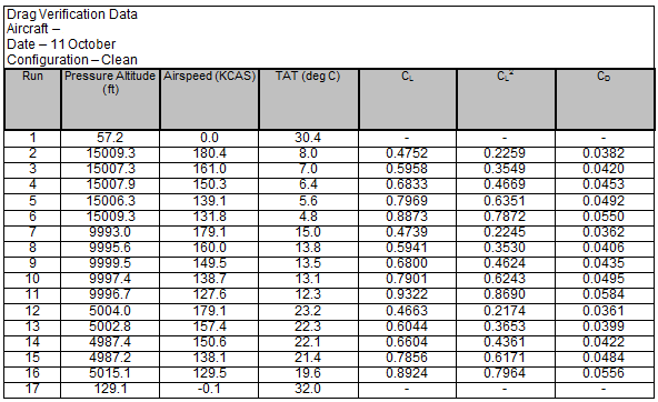

attached is the set of data collected from the test flight and the drag polar (CL vs CD) plotted by me using excel. Based on the drag polar plot, how do I determine the Cd0 (parasite drag) as I do not see the curve touching CL=0. Am I plotting it wrongly? I used all the CD and CL values computed from various altitude on the plot.
Flight data:
Drag polar:
OR
should I plot CD against CL square and form a best fit line and deduce the value for the constants Cd0 based on the drag polar equation as shown:
following is the CD against CL square curve that I have plotted using excel:
Can i say that Cd0 is the value where the best fit line touches y-axis?
Hope you can help me to clarify my doubts, many thanks!

personally I'd plot the Cl vs Cd graph with three different data sets (for each altitude), get the best fit parabola equation for each (to see if they all agree).
You might get the same answer from the Cl^2 vs Cd plot.

Can I clarify that so for the second method for finding Cd0 (CD against CL square), if 3 different data sets (for each altitude) are being plotted separately, wouldn't I be seeing 3 different Cd0 values? So this links to the next question:
does value of Cd0 changes with different altitude? I only know that CD and CL do as they are affected by air density (density reduces as altitude increase) and velocity.
Or do I compute a best fit line out of the 3 curves like what I did (as posted above) and get the cd0 value that touches the y-axis.
Your help would be greatly appreciated, thanks!
RE: Flight test on aircraft's parasite drag
Cd0 "should" be a property of the plane, and I suspect you're right (that the three sets will give three different answers); and the best fit of all data would give another. I suspect if you go the drag polar route you'll get another three (or four !?) answers !
average them all ??

Basically the objective of this project is to compare the Cd0 (parasite drag) of an aircraft with clean configuration and with installed structural modification. Of cause there is another set of similar flight data (also collected at 3 different altitude) for the aircraft with installed structural modification and is not posted here.
So to do that, I am thinking of obtaining the three x Cd0 values (due three different altitude) for the aircraft with clean configuration and three x Cd0 values for the aircraft with installed structural modification via the CD against CL square plot. And do a comparison on them. Not sure if this is the right way to do it, just looking out for suggestion.
Also is the TAT (Total air temperature) data provided even required for this experiment? Seems useless to me...
wouldn't the difference between the two show up as the delta between the two plots ? ie wouldn't a change in Cd0 translate the drag polar ?

Hi all,
so I have managed to compute the Cdo (parasite drag) for the aircraft in clean configuration and with structural modification and are as follow:
Clean Config
@15k feet, Cd0= 0.0316
@10k feet, Cd0= 0.0282
@5k feet, Cd0= 0.0279
Structural modified
@15k feet, Cd0= 0.0308
@10k feet, Cd0= 0.0288
@5k feet, Cd0= 0.0295
Based on the comparison of the 2 different configurations (Cd0 obtained @15k feet for clean config is compared with Cd0 obtained @15k feet for structural modified etc...)
Observation: Differences in the value of Cd0 tends to be more significant (wider) when the aircraft is in a lower altitude. why is this so...? any idea?
is 15000' right ? (more drag in clean config ??)
Hi rb1957,
it is computed from the flight data recorded. Hmmmmm... probably I would suggest one more run to verify the flight data @15k feet in clean configuration, what do you think?
and I observed that difference between the Cd0 values of clean and structural modified configurations tend to be more significant (wider) when the aircraft is in a lower altitude, any rational behind it?
