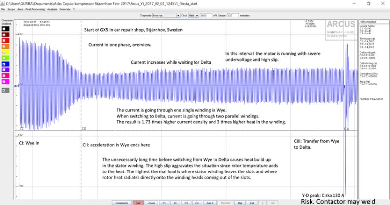

I am investigating a similar problem right now. But it is not about contactor welding in the first place. It is more about motor overheating and overly cautious setting of the Wye time. Timer is now set to 4 - 5 seconds while no more than 1 second is needed. There is a recording, showing current in one phase, attached. To the extreme right, you can see the transfer from Wye to Delta and the associated high current peak.
We are now testing with a shorter time, around 1 second, and are going to test with an even shorter time so that the induced voltage from rotor flux is reduced. The motor and load (high inertia) are then rotating near their design speed and the reduced rotor flux avoids the high current peak.
There are also other things to consider, like the rotor position fall-back and the phase shift during switch over.
