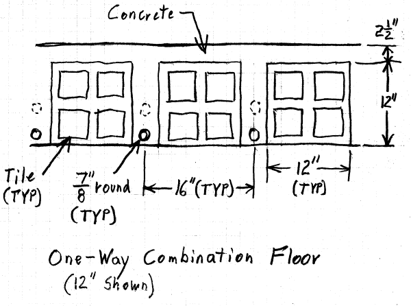

I have an existing 1920s building where the floor framing appears to be concrete pan joists and the designation on the drawings is 12" TILE - 2-1/2" SLAB...Is anybody familiar with that? Is that saying the total depth is 12"? Was there a standard width for these I couldn't find it on the drawings. See the attached image for a partial plan view hopefully it came through, Thanks in advance.

This is not an arch system - it is exactly what stevenspm states - using tile as a stay-in-place form.
The 12 inches is the vertical depth from the bottom of the concrete joist web up to the bottom of the slab. Then you have 2 1/2" of slab for a total joist height of 14 1/2".
It appears from the plan you provided that each rib has (2) two 7/8" or 3/4" diameter round rods as bottom reinforcement spaced at 16" o.c. This implies that the ribs formed by the gaps in the tile forms are 16" o.c. I don't see where the rib width is provided but you could probably very easily verify that at the building. There might also be other notes or typical joist details that might indicate the horizontal layout of the joists.
Just as a side note - the usual challenge with these joists are the shear capacities - usually they were not supplied with any stirrups or ladder bars to provide Vs to supplement Vc. So you are stuck with Vc only and it seems that engineers prior to the 1950's didn't really have a good grasp of shear capacity.

JAE & stevenspm have convinced me this is not "Terra Cotta Arches", but a "One-Way Combination Floor" per JAE's description:
For these floors, tile width seems to have been standardized at 12". Various heights were available, including both 8" and 12". Common concrete joist widths (between each tile) were 4", 5" and 6". A 4" joist would put the rebar at 16" O.C., as specified. The callout of 2 rebar is a puzzle... perhaps they were spaced vertically in the joist.
This is my concept of the detail, see pages 367 through 371 of the 1934 Carnegie Pocket Companion for background info:

Would the 2 bars perhaps be one bottom, one top? I think this will require some minor destructive investigation to find out exactly what is there.
RE: 1920's era concrete joist designation
I've seen both, hokie66. Usually there was a straight bar and a bent (truss or crank) bar side by side at midspan. In SRE's sketch they are shown one above the other and there's no mention of "crank" bars on the plans.
Your suggestion of minor destructive investigation is appropriate if the more conservative assumption doesn't work after trying first. A small chipping hammer on a couple of joists near midspan would reveal what's there.
