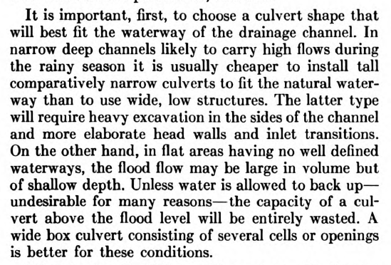

Quote (LQQD)
Is having the culvert side by side situation worse than having a single barrel culvert under a determined fill height?
From "Concrete Culverts and Conduits", 1941:
A multiple barrel culvert will tend to collect debris at the partitions between the cells - more clean-out maintenance than a single barrel culvert.
