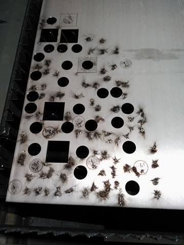

Now I will show you some photos of the "quality" (yes "quality", because its look like it appeared from the darkest sea with tons of sea grass attached sadeyes).
Bottom of the cut (Sea-grass) -

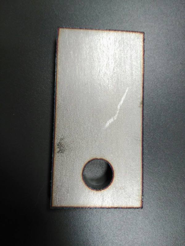

Pierce (kind of good)-

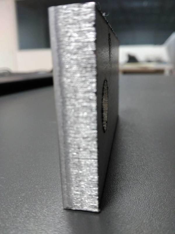

Cut "Quality" -

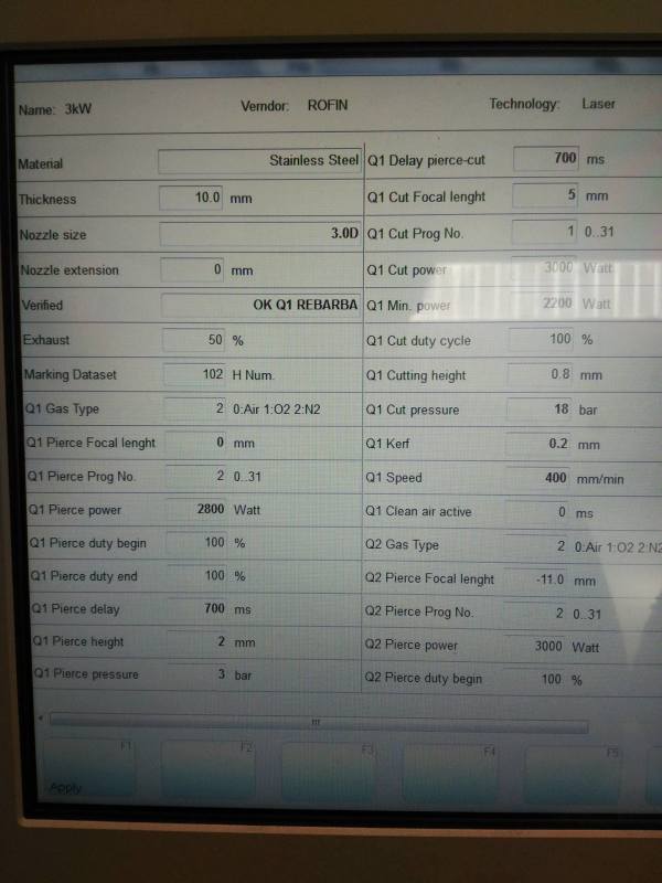

Table Parameters:
With this, what you think I can do to have a good cut?
By the way, with this table parameters I've tried to cut a square and i couldn't , just a solid big thumbsdown .
Well thank you for reading, and hoping for awesome help thanks

Can you upload a better picture of the table parameter? Have to focus abit to much to read it.
RE: Help cutting SS 10mm - 3 kw Rofin Laser (New to the Laser World)
The table parameter its different now but the results are the same (unfortunately dazed), so the new one is:
Gas Type : N2
Pierce Focal Lenght : 0 mm
Pierce Power : 2800 W
Pierce Duty Begin : 100 %
Pierce Duty End : 100 %
Pierce Delay : 700 ms
Pierce Height : 2 mm
Pierce Pressure : 4 bar
Delay Pierce Cut : 700 ms
Cut Focal Length : - 4.5 mm
Cut Power : 3000 W
Min Cut Power : 2000 W
Cut Duty Cycle : 100 %
Cutting Height : 0.7 mm
Cut Pressure : 8 bar
Speed : 600 mm / min

Not sure if you figured it already but if you have then let us know what you did. My first guess is that your pressure is way too low to be cutting 10mm. I suggest going to at least 21 bar or 300 psi. I also suggest try bringing the focus even further down to around -8mm and -10 to see whether or not the increased pressure helps.

gotpho get it right,focus -5.5,-6,maybe even lower,with that kind of resonator you can do about 700 mm/min ,probably no more....nozzle stand off 0.5 mm not lower,with pressure you can start with 11 bars and go higher and higher.....for piercing you its litle bit to close to material that 2 mm also you dont use pulsed for SS NEVER.....duty cycle you have for good reason so you can not pierce with same power through hole ciycle of piercing,also dont use diferent focal lenght for pierce and cut....if you need more info my mail is kr733ac@hotmail.com

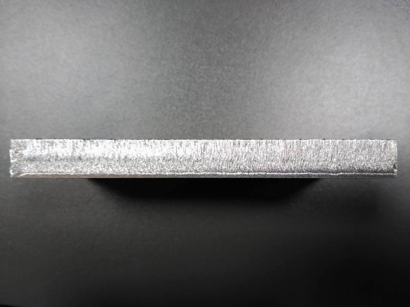

I've had a litle time to do more experiences and I've to say that it was hard to get the results. But here they are:
1-
2-
3-
4- PARAMETER -
The parameter are the ones identified with Q1, the Q2 are other that aren't defined.
It was hard, but i'm happy with the result. I have always to take off the gross, but its better to do that and having a cut, than not haveing a cut at all. upsidedown
