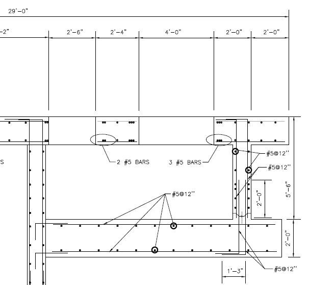

Our firm often does water treatment plants with submerged tanks/lift stations having concrete caps. Often times they will have all sorts of holes in them for piping or mechanical access. We have corner bars, but the main reinforcing runs parallel to the holes.
A conservative quick and dirty design is to assume the hole is not there. Then take a 1ft strip of the slab/cap along the hole with an appropriate tributary area and treat the 1ft strip as a beam. If its simply supported you can just use wl^2/8 and design for steel in that 1ft strip.
Attached is a detail we have used before. It's a below ground valve box with a concrete cap.

JoelTXcive,
Thanks a lot for this, it's a pretty similar project to what you describe. Good to see your standard detail for comparison.
