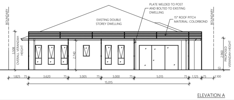

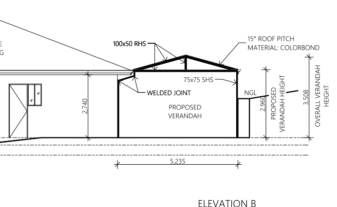

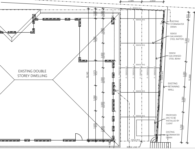

KootK, excellent post mate, thank you very much! Ok, so ive attached some sketches below. Just ignore the member sizes for the moment. All members in the truss are to be 100 x 50 RHS welded together. The trusses are going to sit on the perimeter beams with a cap connection with a bolt either side - acting like a pin connection. The columns are slightly offset from the perimeter beam and are bolted to an existing house on one side.
What i wanted to do was put as little lateral load into the perimeter beams as possible. I'm just struggling to model this at the moment. Any help would be fantastic.

the left hand support (beside the house) looks pretty "flaky" ...
it looks like part of your problem is having an unobstructed face (away for the house, with just some vertical posts). So the lateral loads have to be reacted at the house, unless you make these posts cantilevers (maybe the lateral loads are small ?). Maybe add a truss in the horizontal plane to take the loads towards the house side ?
are you trying to minimise the interaction with the house ? why not tie into the roof structure (as shown, rafters and such) ?

I agree that the column looks 'flaky'. Also, Elevation A shows the fascia to be level whereas the plan seems to suggest it is sloping down toward the north.

I was planning on bolting the posts into the existing brickwork. Yeah the the drawings are just s rough sketch st the moment. What do you guys mean by flaky? I was more so just trying to understand yh loading path from the trusses into the perimeter beam. My question is do I need to put the lateral load caused by the dead load from the truss into the perimeter beam? Shouldn't the bottom chord prevent this from happening even though it's pin pin at each end? I thought I'd only need put the wind lateral load into it.

the kinks in your LH support make it look "flaky". do you intentionally choose not to support on the existing roof ? why ?

I almost spit my coffee out when I saw that column. I expect making it structurally adequate would be difficult.
The support on the left looks flaky because it's not a direct load path, it develops a moment in the column, needs a lateral reaction at the ground, and would potentially have a lot more compliance than an appropriate tie into existing structure, or a straight column between the truss end and the foundation.

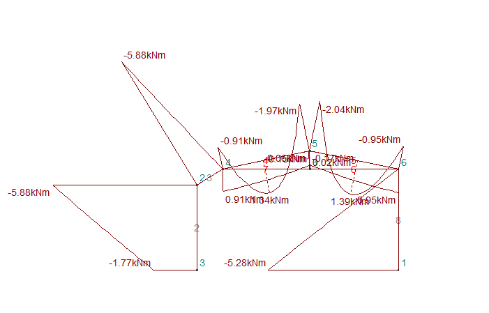

your plot is showing moment in the upper truss chords, yes?
if the truss elements are bends, all normal truss behave is "off the table". Traditional truss elements react axial load only.

BAretired: Elevation A shows the fascia to be level whereas the plan seems to suggest it is sloping down toward the north.
I second this sentiment. It's fine to design wacky shaped stuff, but you need to start with the right geometry. More than once I've had to point out to an architect that what they're showing in plan and elevation is a warped surface.

I'm really not a fan of those whacky cantilevered columns, are the deflections OK? Even if it works on paper it just doesn't feel right.
What's driving the truss locations? Why don't you align the trusses with the 'whacky columns' and design it as a fully welded fixed frame. Then you can have pin-pin supports at the base. Much cleaner.
