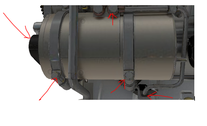

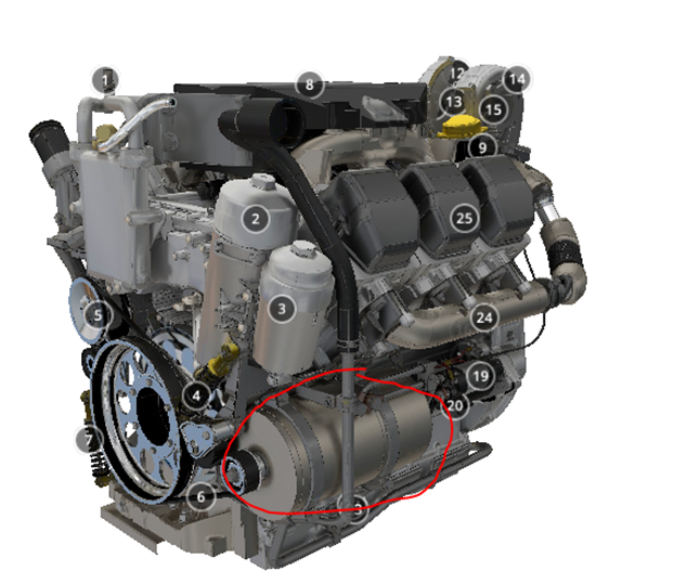

I’m making a training tool/website to help people learn about engineering, but I’ve got a bit of a problem. I was working on 3D model of an engine and labelling parts etc. but there is one piece whose function I do not known (see below image).
I’ve asked around but no one I know seems to know what it is. The second below image is a close-up.
This is what I do know:
• Lit is belt driven so it turns (possibly centrifugal filter?).
• The pulley is small so it turns fast.
• There seems to be a connection to the lube oil sump.
• There are jubilee clips so it is easy to remove (which again points to some sort of filter).
So, does anyone know what it is? Item ‘2’ on the below image is for a lube oil filter (probably, informed guess), so why would they have a secondary filter on the suction side of the lube oil system (assuming that it is a filter and it is related to the lube oil system)?
The model can be found at the link below, it is interactive so you can zoom in to get a better look etc.

RE: Need To Help Four Stroke Combustion Pump Engine
I think it's a heavy duty truck alternator, cooled by engine oil.
I agree. Nothing else looks like an alternator - very nice animation.
I think the two bits sticking out the far end might be terminals to connect some heavy duty cables. Also the clips holding it on are not jubilee clips but heavy duty clamps.
Betting it's an alternator and that's what the two cable studs are sticking off the back of it towards the starter. I have a hard time seeing where you'd want to scavenge motor-oil at 16,000 or more rpm.
Yes. oil cooled alternator.
An 11kW alternator!! 450A.
