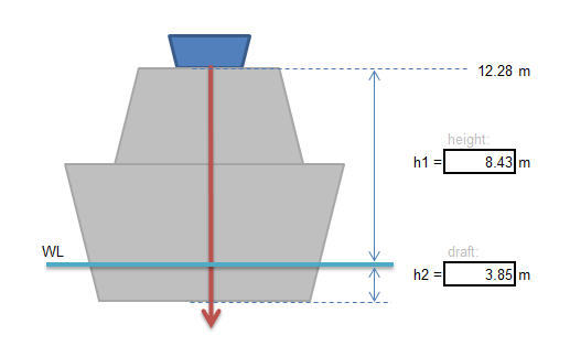

Problem: We have swimmingpools and whirlpools on our yachts and they have an emergency drain which must drain the (whirl)pool within 3 minutes. I figured out the maths for a normal drain (diameter) which has the outlet on the side of the ship just above the waterline. But now they ask for an outlet under the waterline so they can rout the (rather big) pipe straight down through the ship with the outlet at the bottom of the ship.
Question: How does a pipe outlet approx. 3 meters under the waterline decrease the time of draining for an 'open water tank' (whirlpool).
My thoughts: you will have an additional backpressure at outlet (3m under water - 3kPa extra backpressure), but I'm not so sure and I can't seem to figure out how much it will decrease. I only need to have an indication, as there can be all kinds of unpredictable turbulent flows and of course we take a safety factor, and the end result will only be the choice for a pipe diameter.

The backpressure added by the 3m depth of water outside the hull is canceled by the new 3m of liquid draining from the inside, so basically that's simply balanced. Except for one thing, it adds 3 meters to the pipe, so flow losses are at least that much greater.
I think I would be more concerned with dynamic pressure variations from changes to the water level outside. That will tend to force water up into the drain as the immersion depth increases, or "suck" it out when the water immersion depth decreases. The first might be helped with a check valve, although draining in progress would be temporarily stopped, but the second might suck the pool dry. Do you have a vacuum breaker or vent?
Careful with the changes, or complete reversals of velocity that might happen in those flow direction change circumstances. You might also have some trouble with placement of the drain on the hull. One place might have velocity induced venturi pressure changes, such as pitot tube pressures picked up if the drain outlet faced somewhat forward into and catching the oncoming water, or negative pressures that might result from water slipstreams past a flush-mounted drain.

The extra flow losses because of the extra pipe length is already taken into account. I took the height from bottom of the pool to the waterline now, so that's fine right?
In practice the pipe will be partly filled with seawater (up to the waterline) so you might have some trouble with locking some air during draining (3,5m^3 through a DN165) creating bubbles and some other hydrodynamic processes, but I think these can be ignored, as we built in safety by selecting one or two steps higher DN.
There is no vacuum breaker or vent no. There is an automated emergency valve all the way up in the drain line which will only be opened in case of emergency.. and the process will (hopefully) not be used very often.
I added a simple overview:
When class society comes timing the (3 minutes) draining, this is done in harbour condition, so there will be no problem with ship velocity inducing venturi pressure changes, am I right?
