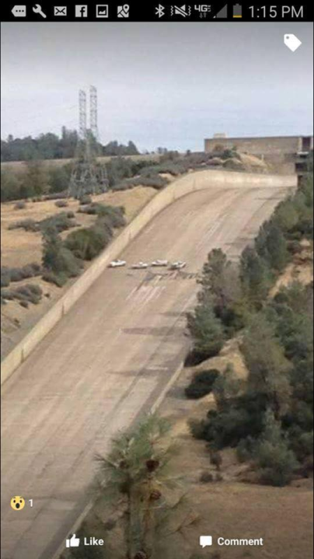

While not an accurate news source I saw this on imgur this morning: http://imgur.com/gallery/xHfxx
Apparently the current solution is to try to use the spillway at reduced capacity:
American Concrete Industries
www.americanconcrete.com
RE: Oroville Dam Spillway Concrete Failure (Feather River Flooding, CA)
So total collapse of the spillway surface off the edge and the water is now going around the spillway - probably further taking out the underlying soil beneath the spillway slab.
Probably will take the whole thing down to the bottom before too long.

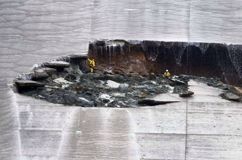

Hmmm -- A picture ostensibly from 2013 -- looks like they're checking out that area of the spillway.
... and it sure looks like what they're investigating is water coming up through the spillway paving.
Where do you suppose such water might come from?
Mike Halloran
Pembroke Pines, FL, USA
Perhaps from "a substantial water flow that you don't see."

As an observation on the photo above, there's a lot of water seeping through the drains into the tailrace from the surrounding land. Ground conditions must be very wet there.

I got a 404 to that link, but this is where I think they were concerned - I would have been.
Basically the end of the concrete ramp where the water from the rest of the area is funneling down, threatening to get behind the concrete wall.
Also very difficult to inspect until the water stopped.

Quote (LittleInch)
The mighty engineer
Fixed the link but it's the same area you showed.

Story from the LA Times today. There is a picture about halfway down the article, that shows the hole in the ground and the roadway washed out, after they got the lake level down enough to stop the spillway topping over.
B.E.
Good description and the big hole was probably what caused the initial fear, but this one to me is more worrying.

Apparently on some other sites there is an explanation for the water spouts into the main spillway from side walls. There is a drain system under the base slab, with pipes on an angle leading to side walls and then into a sloping pipe under the exterior wall backfill, periodically dumping the collected water into the sluceway. Cracking the concrete base slab in many places seems to follow that diagonal drain locations.
Another view showing cracks.
"Another view showing cracks."
As Adam Savage (ex Mythbusters host) would say:
"Well, THERE'S your problem!"
The question at the spillway with cracks above the perforated drain pipes tends to indicate a thinner slab at these locations. However, the mix of materials going into the product as well as the site conditions have a great deal to do with potential for cracking. A major player is the water content of the mix. Generally the higher the water content, the more shrinkage that may occur later. I've noticed on some jobs that within as little as less than an hour that shrinkage has started.

In one of the movies shown by Juan the-777-longhaul-pilot the concrete looked to be pretty thin in the
area it failed. Everywhere else it was about 3 feet thick but right-of-center it looked to be only about
half that.
Mtown's posted pdf file includes this comment from said consultants at page 7:
"Chute Spillway [Gated Spillway]. The chute spillway [Gated Spillway] has operated many times since its completion in 1968. Although the floor of the spillway chute [Gated Spillway] in this section has experienced a good deal of spalling and cracking, there has been no significant damage. The cracks and spalls have been repaired several times."
I.e. the floor of the spillway has been accumulating damage (spalls and cracks) every time it is run, likely from cavitation. "No significant damage" is a phrase that just sets off alarm bells for me, it is just too similar to the language used by NASA prior to (and in some cases after) the Columbia shuttle disaster. "It hasn't failed catastrophically yet"
Underfloor leakage (side drains run full when the spillway gates are opened) and subsidence is also noted, but the source of that water is not clear, but is likely moving through cracks and leaking expansion joint seals along the floor of the spillway. I.e. cavitation damage leads to leakage, leads to subsidence and further slab breakup, more cavitation and erosion, and a literal cascading disaster develops...
