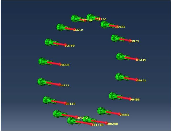

Hi
Could you advise the method to find the resultant force , remaining tension on bolts from abaqus results.
A photo of the expected result image is attached .. But I am not familiar with the method of producing an output like this .
Thanks in advance .
RE: Abaqus bolt tension output..
Looks like a symbol plot of CF1 (bolt load) or RF1 (bolt reaction force), with the additional option that shows the values/label in the display.
See A/CAE Manual 45. Plotting analysis results as symbols
