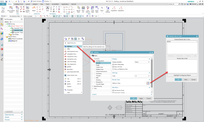

Where do I find the render sets option to apply for a view in NX 11?
I can create groups and add parts to it in settings, but when I go into settings of a view and general tab I don't see render sets option like in NX 10

For the view, Settings, Common -> General -> Render Sets group -> Define in View (see image below).

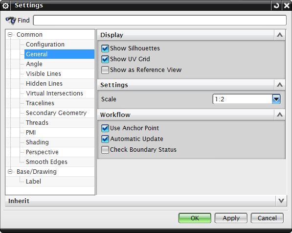

RE: Render sets NX 11
Strange, I just tried it out in another assembly drawing and it showed the option like you showed.
But in another drawing( for which I posed the query) I don't see it.
Attached image of settings box.
Pratham,
Using NX 11
Thanks Anthony...That solved it...I had to expand the settings from collapsed....
Again thank you very much...but I wonder why when I created another sample/test drawing to check the render sets option, it was in expanded state but collapsed in the other drawing...
Aren't they supposed to be in the same/ last used settings/state?
