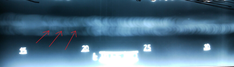

this is a problems on the RT films of piping welds, which one can give me a reasonable explanation.
on the films one indication (a dark line on the root weld edge ares )looks like lack fusion ,but as my and my friend many year experience, this is not the lack fusion.
the welding process is GTAW +SMAW for 6” pipeline
anyone can explain why this dark line appeared ?

Looks like a bit of undercut on the toe of the root side. If it were incomplete root penetration it would be more toward the center of the weld cross section (assuming the 2 top passes are even over root). Any side wall lack of fusion would be broader and somewhat uneven along the length of the indication. Any way to confirm with mirror or borescope / camera on ID of pipe?

we cann't see the inside surface of the pipeline, undercut is impossible because of the undercut indication cannot appears so straight and even.

What is your problem ?
It is root concavity and is perfectly acceptable (based on the evidence above).
Are you a radiographic interpreter ?
Why are you posting these films and saying you have a problem - has your RT company rejected them ?

It looks like a line goes from maybe 12 to 26; It's a fine line that looks like it wanders a bit. It looks like it ends where the weld overlaps the start point. A higher resolution image might help. Attach it as a file, not as an embedded image.

Why on earth would you have GTAW vertical up and SMAW (cellulose) vertical down - very, very strange ?

this is no central dark strip indication, so root concavity is not possible.
