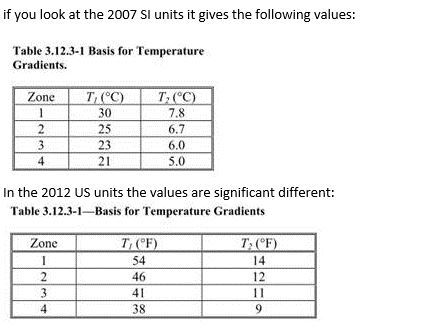

I spotted something odd in between the AASHTO 2007 SI units and the US version for the temperature gradient cl 3.12.3.
If you look a the San Francisco Oakland bay design criteria it also say that 30oC = 54oF:
http://www.dot.ca.gov/hq/esc/tollbridge/SFOBB/East...
It looks like there is a mistake in the conversion from Fahrenheit to Celsius forgetting to add 32 to the values in brackets?
