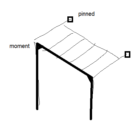

Hi, Id like to design a new steel construction for balconies next to existing house.
My experiences with steel constructions/connections are limited so I have few questions.
1. main frame (marked red) has to be a moment frame, but side frames dont have to be, right?
2. stability of construction is provided by a house in Y directions and by a moment frame and bracing in X direction
3. bracing in balcony plane is mandatory, right?
4. supports has to be fixed?
5. what do you guys think about my connections, are they alright? something more simple, cheaper?
I would like to get a design/model right from the start. Calculating connections would not be a problem for me, but to choose the right/best ones is an issue for me.
I was trying to use RHS profiles but Im not confident about connections. I think its better and easier to choose H profiles?
I really hope you guys will help me out with some suggestions and pictures of connections.
tnx in advance

Don't understand why you think you need anything more than something like this,
Moment connections resist sidesway.
Why do you want each beam pinned into the house wall.
All you need is 2 per floor. Then you could make the balcony floors in the shop.
Take them out to the field and bolt them to the moment resisting frame and the building wall.

Quote (OP)
Right, as long as the existing structure can stabilize the decks perpendicular to the moment frame.
Quote (OP)
Agreed. With a floor diaphragm of some sort (bracing/sheathing) at each deck, you might even be able to get by without the moment frame. It depends what you're able to grab on to within the existing house. That said, there's certainly nothing wrong with your moment frame concept.
Quote (OP)
I don't believe that it is mandatory so long as you've got that moment frame.
Quote (OP)
They don't have to be. That's an engineering judgement that you, as the designer, are at liberty to make.
Quote (OP)
Is wood construction and option here? In my neck of the woods, we'd do this with timber posts, a deck diaphragm, and no moment frame.
What is the existing house constructed out of? Wood? Concrete?

Your moment frame will do what you want it to do but it is a heavy design and probably more than is required. My concern is your connection D. I would only bolt back to the existing house like this if you knew that the wall you were fixing to was reinforced masonry or concrete etc. There isn't much load here I know, but its not really good practise, especially if it is non-structural brick veneer. If the deck floor can diaphram brace back into the house then I think you can really reduce the moment frame.
RE: steel construction for balconies - profiles and connections
Reducing the moment frame strength would simply tend to put more load into the wall.

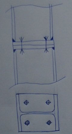

tnx for answers guys.
one more thing id like to make it clear. What about column to column moment connection? is it OK?
Since column most likely would not be in one piece I was thinking about connecting it like this (picture) where bending moments are almost or close to zero.

That's really more of a pinned connection, however if there is no or little moment, you don't need a moment connection.
Reaction to change doesn't stop it smile

I don't love it. If it's aesthetically tolerable, I'd prefer to see some bolted flange plates. If you're placing the splices at low moment locations, that probably means around mid-height between floors. And that's right about where you'd really like to have some flexural stiffness in your column to prevent it from buckling. You could design the fame to accommodate a pinned connection at the splice but that's pretty unconventional. And there are other things that could be done to create a stiffer connection while still keeping it inboard of the flanges.
