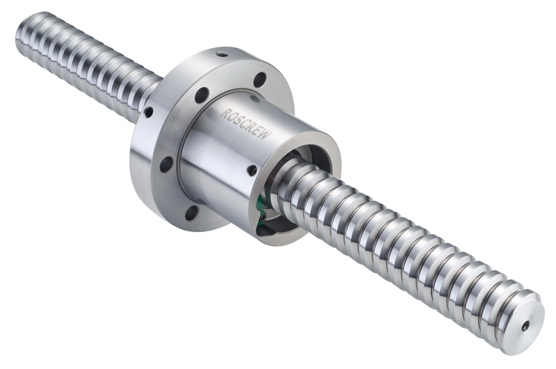

Hello everyone,
I am trying to manufacture a Ball and Screw Inerter for my research.
can some one help me on how to attach the ball nut to thrust bearing.
So that it should not move, when the screw rotates.
Thanks in Advance

Hi Mike,
I will attach the ball but to a fly wheel.
So when nut rotates, fly wheel will also rotate.
ball screw can be used in two types
1) when screws rotates, nut will have linear motion
2) when screw translates, nut will rotate.
I thought of using the second one here,
The problem is how will i attach the Nut to a Fly-Wheel.
- Fly wheel
- Ball screw Mechanism
How to fasten these both, please help me.

Rather than trying to adapt a spoked pulley, go to your steel service center, and have them flame cut a disc from ~2" plate, bore a central hole to fit the ballnut shank, and drill and tap a pattern of holes to fit the ballnut flange.

I am manufacturing a miniature one.
It will be about 3-4 inches in length and 1-1.5in in diamater.
I though of 3D printing a fly wheel and i will attach the nut to the hub.
The problem is the nut is of very less thickness.
So how would i attach that to fly wheel hub?
RE: Ball and Screw Inerter
I hope you are buying a commercial ballscrew assembly.
The nut will probably have some kind of flange with multiple through holes for bolts.
Make your flywheel from a piece of steel plate.
Actually, for 1.5" diameter, it could be sliced from a ~2" steel bar by any competent machine shop, in less time and for less money than a 3D printed anything will cost you.
This would probably be a good time to start work on a proper assembly drawing of what you propose to build. That should help us both understand what the other is talking about, and allow my friends here to also comment.

MIKE,
Even i thought the same.
I will try to attach the fly wheel to the flange of the nut using bolts.
