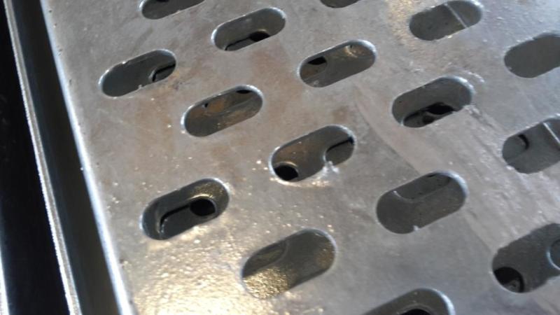

We are doing both electroplating and HDG. In HDG we are facing so many problem in surface finish and post process finishing work is so high . As it is manual,we are spending so many manpower on same thats why we are suggesting our client to purchase electroplated materials.
In grinding there is big loss of coating thickness of HDG materials . Is there any other method to do the finishing with small machines ?
RE: ZInc plating of wiremesh
Perhaps some photos of your product before and after dipping and before and after finishing would help us understand why you are having to grind HDG at all.

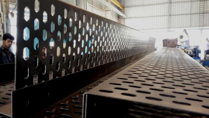

This is before HDG

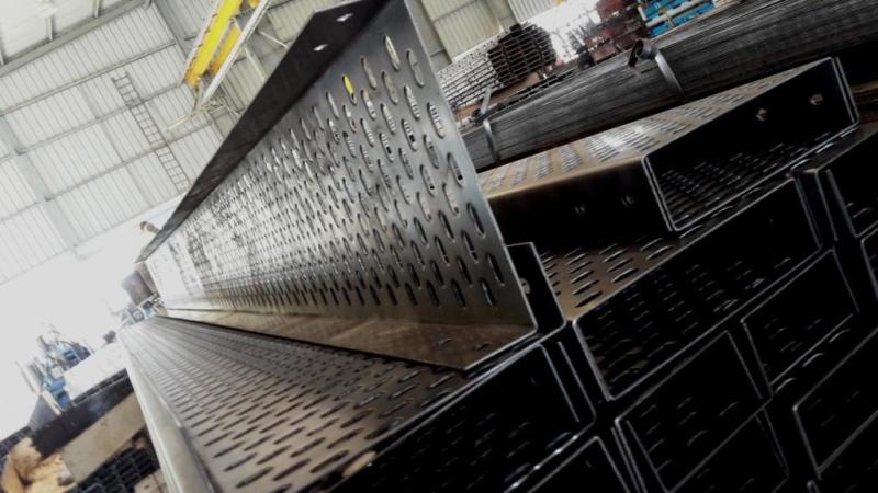

This is Before HDG

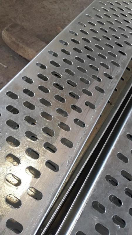

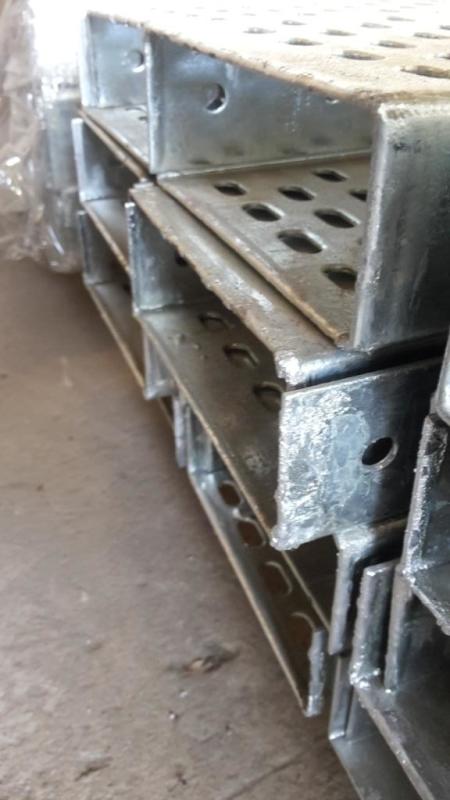

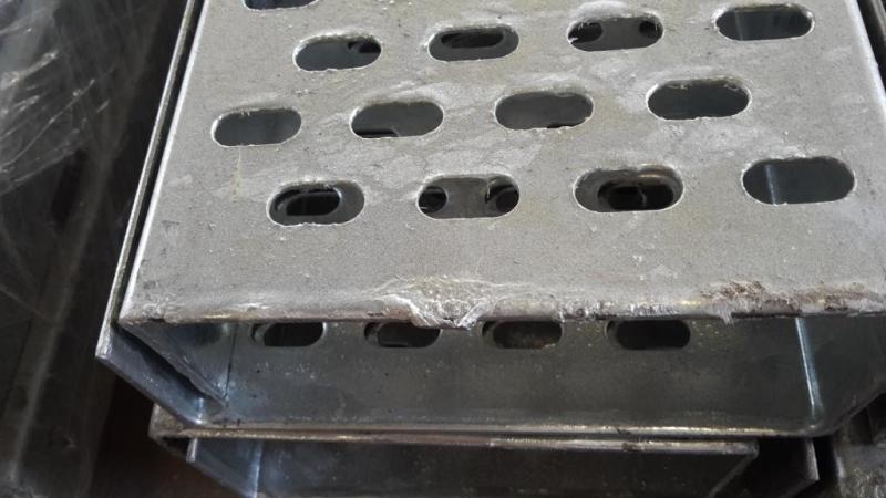

This is after HDG .We are doing filing to remove this zinc lumps at edges and painting with zinc rich paints in the uncoated areas ...

When you HDG, there is generally a 'scum' that forms on the surface and this is usually removed prior to extraction from the zinc bath. It does not appear that this has been done. Your HDG does not appear to be 'clean'.
Dik
I thought you started asking about coating wire mesh. The pictures show something else entirely.
@hokie66
Ysss. but as i mentioned above we are doing electroplating because of these issues in galvanising.
Right. I see you have issues. But the corrosion protection afforded by galvanising is vastly superior to electroplating.

IR... the 'swipe coatings' look like they were caused by withdrawing the object from a 'dirty' tank.
