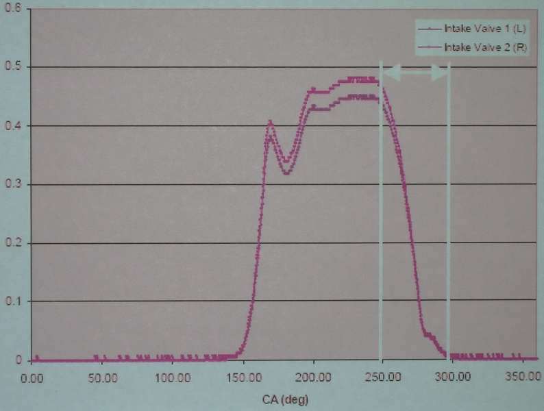

LIM Technology did a study and proved valve bounce to be negligible. Here is a short summary of the reports findings:
"VALVE BOUNCE
Questions raised by knowledgeable people regarding valve bounce were answered in 2006, with the publication of the report by Douglas M. Baker, Ph.D. Dr. Baker describes how valve movement was measured at high speed. Valve bounce occurred on opening, and we know how to eliminate it. Time to open the valve to full lift was faster; dwell was longer, and closing was faster than conventional cam profiles can allow. Valve bounce at closing, due to the small mass of the valve and the deceleration shown in the diagram below, seems to be a non-issue.
The chart above tells the story of valve bounce in our camless engine. Blow down begins at 126 deg. after BDC. It appears that the valve begins to open at 145 deg. In the engine tested, maximum valve lift would be about 0.450 inches. In about 30 deg. of crank rotation, the valve reaches about 90% of its potential lift. After a bounce of just over 1/10 “, ending at about BDC, lift resumes, continuing for another 70 deg. As the valve retracts, its rate of closure slows to a nearly soft landing after the exhaust ports are sealed by the piston. Experts had thought that valve bounce would be a factor in closing the valve, when in fact bounce at closing is negligible. Unlike in any conventional valve train, there is some bounce in the opening, but we think it is benign."
So according to their findings valve bounce is not an issue.

What RPM was the engine running at under the conditions in which that first chart was made?
What was the compression ratio of that engine? What was the peak cylinder pressure? (Higher means needing heavier valves which means slower operation)
So you want to use gasoline direct-injection ... fair enough. Gasoline direct-injection two-strokes are in production by Bombardier for snowmobiles and outboard motors without any intake or exhaust valves at all. (They use piston porting as with normal two-strokes) They do indeed have much better fuel consumption than conventional two-strokes. But these engines are not called upon to meet automotive emission standards. Nor are they expected to last 300,000 km without an overhaul - and that's an issue with any form of piston-porting.
It seems that most inventors are blind to the downsides of their invention. Sorry for busting bubbles but you're not getting me to invest ...

There will be pumping loses with scavenging. 4s engines also have pumping loses; I'd have to research it more to find out which one has higher pumping loses.
The valve design is critical and the good news is this work has already been done by LIM Technology. They designed and patented the valve, although I believe the patent has expired because of non payment of fees.
Here is a picture of the valve:
It is possible to use these valves with a clock spring, or control them entirely pneumatically. I was also thinking about Samarium Cobalt magnets as the springs since they can handle high temperatures; although the temp could be too high but it's an interesting idea if it could work.
Using a valve design like these would sabe a considerable amount of space and weight. They could be light enough, to move fast enough, to work up to decently high rpms. Since I'm focusing on a CI engine the rpms shouldn't be too high anyways. Also, since it's 2s it doesn't need to Rev high to make good torque.
Another thing is the springs for the intake valves don't need to have very much force. Engine tests from LIM found that all the spring does is help the valve close faster. They were actually able to run one of their prototype engines with no pneumatic or metal springs; it ran terrible but it shows how it's really the air pressure that causes the valve to open and close, the spring just helps it return closed. By simply adjusting the force on the valve, allows the valve to open and close at higher rpms; it is similar to a VVT but obviously much simpler.
The reason why the dual charger setup is used is to provide the positive pressure necessary to operate the valves and scavenging. It is possible to use only a supercharger but I believe by having compression done in 2 stages, from the turbo compressor first and then the SC, and using water injection after the TC compressor and before the SC. The dual charged setup would have the highest power potential; it could also be more efficient.
