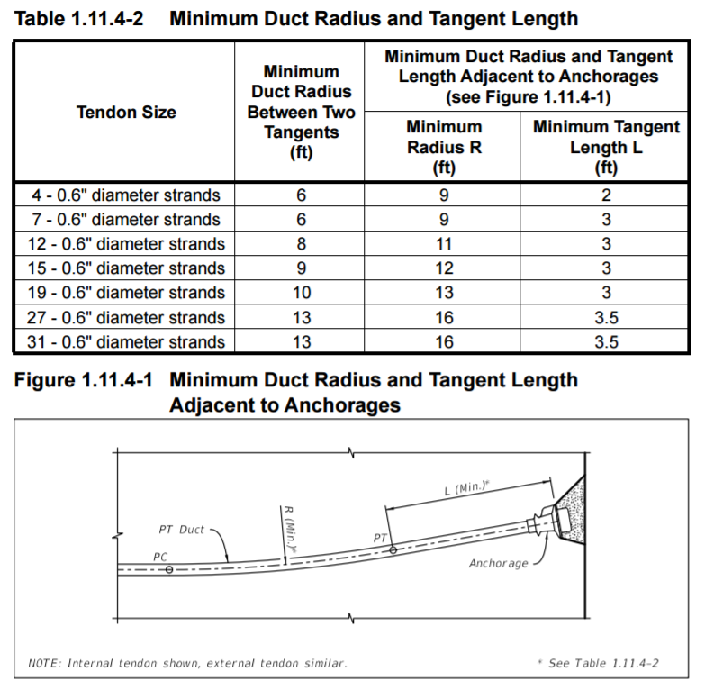

Florida DoT (and I assume other DoT's) require the design engineer to check min. tendon radius, and provide min. tangent length etc:
As far as end-anchorage with sloped ends, the two bridges I have been involved with in the US have both had sloped ends, - as yep, custom recesses had to be fabricated, which is a PITA.

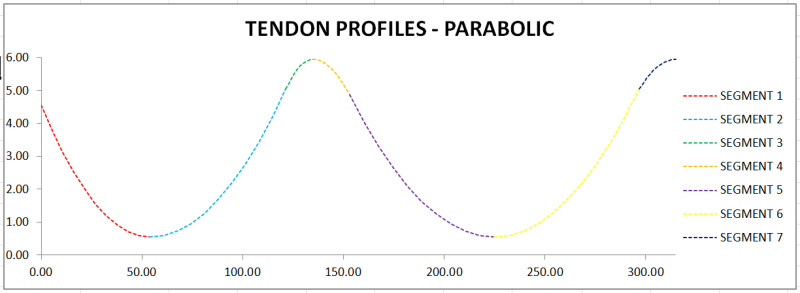

Some what interesting...if you adopt tendon profiles that use CIRCULAR segments, the results for this example problem, in each and every one of the 7 half-tendon profiles, are near identical to using a PARABOLIC segments - to the 3rd decimal place.
For example, the first half-span profile from 0 to 54', here are the profile comparisons:
It is not until you have very small tendon radii/eccentricity ratios that you start to get a few % differences. However, for all practical tendon profiles, even with tight tendon radius, the differences are very, very small.
I am not suggesting using circular profiles, because it is a PITA to use and calc slopes etc, but mathematically CIRCULAR and PARABOLIC profiles will be near identical.
