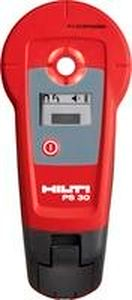

I am aware of the existing concrete condition. My point still stands. Have a structure scanning company come out, locate the rebar, draw the locations, and then you determine a layout of anchors that works.
In our office we have a little handheld rebar locator similar to the one in the picture. It does an alright job, but the companies that do this for a living have much more accurate systems.

Hi, i'm pretty for not being able to answer your comments before. Finally we changed some of the anchorages for a different setup which also has some install time advantages and more tolerance for all connections not just supports. For the remainings anchorages i'll take my bets by locating the rebar with a locator. (sorry for not understanding your post jayrod12, English is not my native language.
