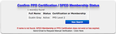

Dustin, what software are you using?
RE: Line List Info on Piping ISOs?
AutoCAD Plant 3D
If you don't mind me asking, how did you know my name? Not that I mind, just curious.
I have secret powers! :)
'DGray' and 'PPD'. Hmmm...
SPED member lookup.
I'm the SPED admin (among other things).
Paul
That is what I was wondering, haha. Are you Paul Bowers?
At the risk of turning this into a chat session: could very well be.
