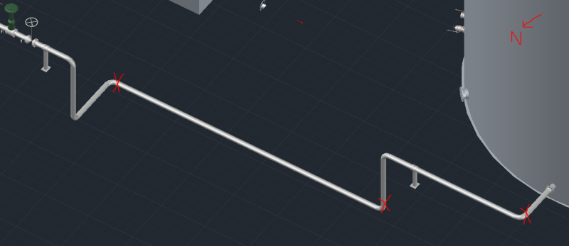

For example, in the image below, some engineers here believe that a field fit weld (6" of extra pipe) should be provided in all 3 planes where I have indicated with an X, instead of just a regular field weld (no extra pipe). The first in the E-W plane, the second in the vertical plane, and the third in the N-S plane. However, it is not for just this pipe that they feel this way. They feel as though there should be a FFW in all 3 planes for just about every line of pipe. From what I have read this seems to be a bad practice and would require extra man hours for a construction crew to have to measure, cut, bevel, and weld nearly all spools. I just want a second opinion though.

DGrayPPD,
Again, I am on your side on an issue.
There is a time and a place for everything.
An FFW adds work and therefore adds cost to the project. Consider some examples: A 3" sch 40 carbon steel line with 3 FFW's. Or a 24" sch 160 Stainless Steel with 3 FFW's. Think about the details involved and the real cost. FFW's should only be used in cases where the project Pipers know they will be needed and excessive FFW's should be avoided.

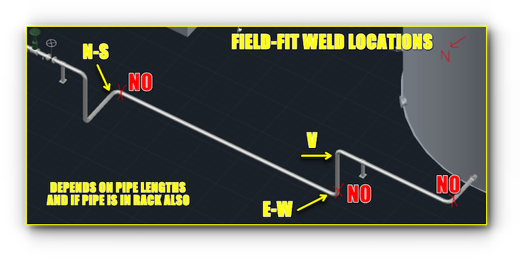

Don't forget that you will have "natural" break points needed so as to fit spool assemblies within the shipping envelope that can also be used as FFW locations. I would move your FFW locations to where I've shown below, based on what's presented in your screen capture.
My criteria was to maximize spool dimension and locate welds in accessible locations. There will be differing opinions on "best" locations, that's why it's often left to the erection contractor.
And of course, modularization solves many of these FFW issues.

I'm going to disagree with you there.
The very long section in the middle should be the field fit (its long leg cut extra long since that is spanning a section between tanks that is very likely to be off. (long or short.) The elbow going to it should be in the first spool, since the long straight will accept a significant degree of offset in all directions (as long as drain criteria is met - but you have no provision that in the spools anyway.)
Only one vertical field weld?

So, when you say, "every line of pipe", you mean a complete line number from origin (equipment or other pipe system) to destination and not sub-assemblies of pipe and fittings.
In many ways, specifying 3-axis FFWs for each line number provides a certain amount of "wiggle room" for the designers but as pennpiper notes, this can get very expensive for large bore / heavy wall / exotic materials.
