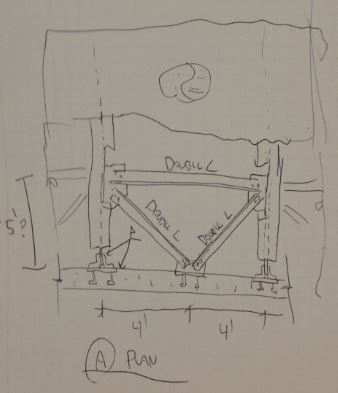

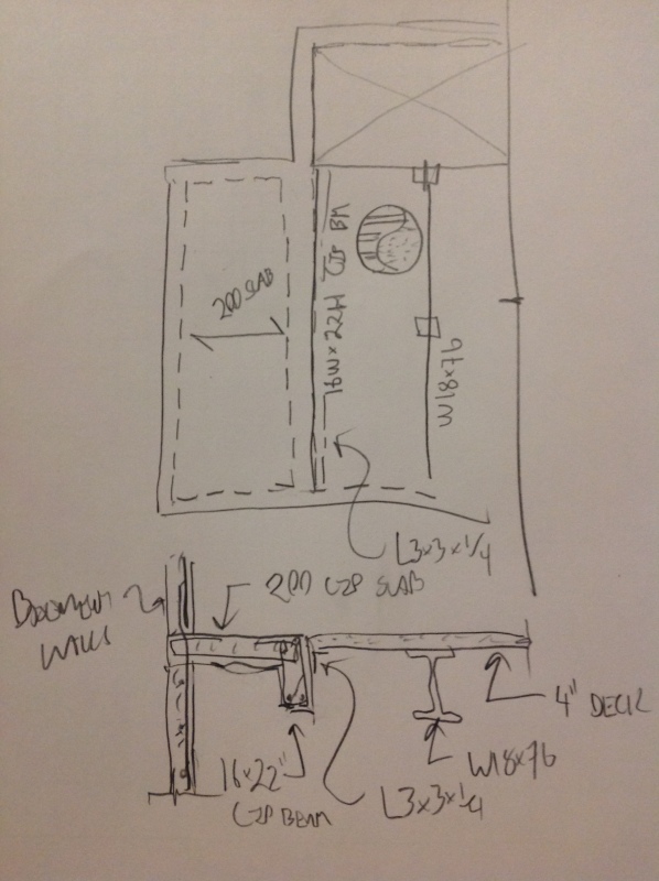

The sketch below shows what I'd fantasize about doing if it were my baby. I like the dowels and bay of solid slab as a means of keeping things sturdy until we're sure that the force is well distributed. Probably overkill. Solid slab soffit could be plywood or 0.6" form deck at the contractor's option.

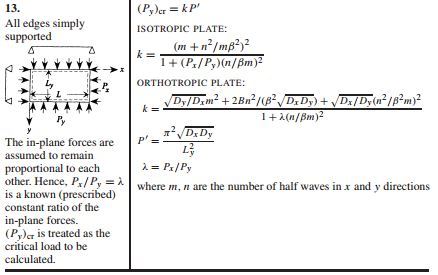

I have used formulas from the book 'formulas for stress,strain, and structural matrices' to determine the in-plane capacity of a slab, but don't recall specifics too much, and it wasn't a slab on metal deck. here is a shot of the formulation:
Roarks may have something similar.

I did a crazy house with a wide-open single-level basement, but not a skip-level like you've got. My takeway was I'd rather not mess around with earth pressure.
You are doing what looks like a very high-end residence. I have been taught to treat these more carefully than commercial jobs, although few builders agree. I prefer to shave structural cost tight where the loads are not realistic/sustained loads (live/wind, etc). For actual felt loads such as earth pressure, I like a little redundancy to mitigate risk. I was also taught to tolerate far less vibration or live load deflection.
In your situation, I would build in redundancy by going this route:
-Reinf the wall to span horizontally. If the wall jogs, lap some zees.
--Use concrete topping 2.5" over 2"
--Do "blocking" beams in the first deck span
--Pretension all bolts in your grade-level steel diaphragm. Much debate here but in my opinion this "locks" your steel grid axially.
--Look at it as 18" cantilevered wall. Coming off a 30" footing with return walls, I think you have this load path too.
--Double-check your column sizes etc and see if you can reduce steel or get a column to fit the stud wall above grade. Throw the architect this bone when you insist on concrete topping.
--If you're really pressed on cost, I think your basement wall thickness can be varied for different walls. 18" is beefy.

Thanks for the plate references structSU10, I'll try and dig into something like that.

RE: Metal Deck over steel best intermediate basement level
- more than I think is necessary.
- less than it sounds like you're planing.
- crazy stiff and robust.
- makes sense with construction sequencing.
- poor quality sketch. Friday = mucho scotch.

I have to ask for my own edification: why not the solution that I posted Friday night? Back to normal deck, no columns on the CIP, and really convincing wall bracing.

I believe the shear forces in the horizontal concrete beam were too high to make it work. With 10k/ft x ~ 30' we have roughly 150k in reaction. Also, in looking at the wall in the other direction we are parallel to the beam framing, but if we tried to transfer all the force through the beams at 8'-0" we would have a reaction of roughly 80k into each beam. Obviously the direct connection of the deck helps transfer the compression force, but if we looked at only transferring it through the beam the reaction felt to high for beam pocket.
Did you not come off a distance d?

You'd be over using just the concrete shear capacity but, unless I miss my mark, a very light reinforcing ratio in the slab would get the job done.

I've been noodling hard on this aspect of things. Given the reality of concrete shrinkage and creep, I don't think that there's any way around having the axial load wind up primarily in the steel beams. The only question, in my mind, is does the load start off in the steel beams or does it travel through the concrete for a short distance before making its way down?
You may have already come to this conclusion by the sound of it. Regardless, I feel as though this means that there isn't really a need for the deck selection choice to be dictated by the axial load condition in the parallel to beam condition. No matter how robust you make the slab, it's just going to be shedding its load to the beams in short order.
The detail below shows one possibility. It would be perceived as extreme for a residential application in my market. You seem to be afforded a good deal more flexibility in your market however. And who am I kidding? Noboddy's got an indoor curling rink at home where I live. Features of the detail:
1) Keeps the horizontal spanning demand on the wall down. Not sure how 8' was working in previous iterations anyhow.
2) Install a sub-diaphragm six to eight inches below the tops of the beams.
4) Maybe gap the deck edge angle from the wall slightly so the load doesn't start out in the concrete.
5) Change your beam connection detail from wall pocket to embedded plate and double angles. Resistance based on punching shear.
