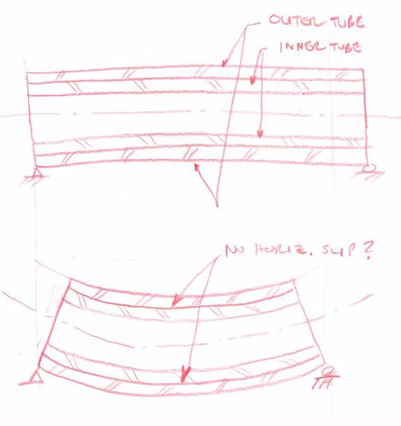

RE: Concentric Tubes in Bendine
In this scenario, bonding is irrelevant. The neutral axes of both the inner tube and outer tube coincide in space and will share the same curvature. As such:
1) The two sections will behave compositely in flexure in the sense that matters: they will share a common strain diagram.
2) The composite section properties will be identical to the non-composite section properties (I_in + I_out).
So there you have it. You get composite behavior but, in this particular case, it's of no particular benefit.

Is it possible that the tubes would not tend to slide under bending, meaning there would be no difference if they were bonded?
That is indeed correct and is probably the key thing to understand about this situation.

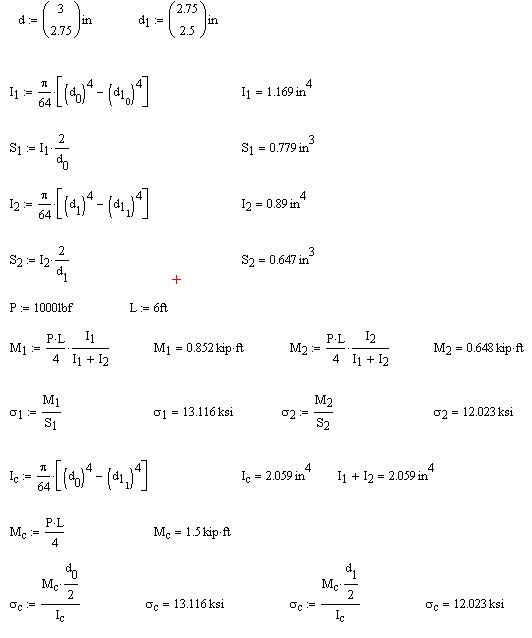

A little proof of what KootK is saying:
The Mc is treating the tube as one, and looks at the stress at extreme fiber of the outer tube and extreme fiber of the inner tube. the results are the same whether you proportion the load by stiffness or treat it as a composite shape.

Thanks for the MathCAD confirmation SU10. But for laziness, I would have done that myself.

if the inner tube was an interference fit, then I'd by that the pair of tubes would act like one combined tube (or like the sum of the Is, same diff)
as a sliding fit, there is an obvious difference and the interface of the tubes between the two tubes and a single thick tube. I'd expect the two tubes would deflect more than a single thick tube.
Exactly right. No slip so long as:
1) The vertical positions of the neutral axes for both members are coincident and;
2) The neutral axes of both members are made to have matching curvatures.
1 + 2 = identical strain profiles for both members at all locations. And identical strain profiles, by definition, means no slip.

CASE 1: tube and tube as described here.
CASE 2: 4X10 main with with a pair of 2x6 sides for reinforcing. The center lines of all member align.
For both cases, I would submit that the following is true:
1) Both members need some mechanism by which vertical load can be transferred from the directly loaded member to the member not directly loaded. Without this, the curvatures of the various members cannot be made to match.
2) For the tubes, the vertical load transfer mechanism is some complex bearing situation, as intimated by rb1957.
3) For the wood, it's vertical shear transfer in the bolts.
So the bolts in the wood are necessary, just not for horizontal shear transfer. Their role is solely to transfer vertical shear and enforce curvature compatibility among the plies. Fundamentally, this is why we don't have to bother with VQ/It forces when we laminate multi ply wood beams of the same depths. There's just no demand for horizontal shear transfer.

It occurs to me that we normally neglect shear deflection in beam deflection problems, but if that was considered, it may no longer be possible to get them to deflect identically under the assumptions made. That is in addition to any end effects mentioned above.
the two tubes are constrained by geometry to deflect the same.
I finally ran the numbers on this and Koot was correct all along.....as he stated, composite action is not required in this example and the stiffeness is the same for 2-tube setup versus the solid equivalent tube.......learn something new everyday wheather one wants to or not...Timoshenko is again resting in his grave, if not in the same position....
Quote (SAIL3)
Hey, even a blind squirrel finds a nut once in a while. Thanks for doing the leg work and for reporting back to share the results.

It'll work so long as the respective neutral axes of each piece are at the same location.
If there is a small gap between the inner and outer pipe in order to achieve a sliding fit, the inner pipe will have a smaller deflection than the outer pipe and will tend to feel a single load at or near midspan.
BA
I agree with BAretired. When placing the smaller tube we will have 3 cases.
First one, the smaller tube is a little bigger than specified and then it won't fit without getting a lot of residual stresses.
Secondly, the members perfectly size each one another and then it will behave as described.
Third, probably the most common situation will be to have a gap.
I agree, the truthiness of the theory discussed above is sensitive to the ratio gap/deflection. An eighth inch gap in a system deflecting three inches is surely of little consequence. A half inch gap would be a different animal.
Quote (KootK)
In the interest of precision, let's revise that to:
It'll work so long as the respective neutral axes of each piece are at the same location and are made to travel in unison.
