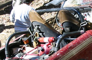

I'm sure the references listed above will cover the question of strength of your attachment points, but for what it is worth, photo below shows result of a 4 point roll bar tied only to body sheet metal without appropriate body reinforcement or frame tie-in.
I witnessed this slow speed rollover on a rock face where the 4 point attached roll bar had two of the roll structure feet go through the floor to be stopped only by the leaf springs directly below. The failure mode was a combination of the 1/4" roll plate foot shear cutting through body sheet metal and body spot welds tearing apart. Driver was very lucky to have no injuries.
Ron Fournier's Metal Fabricators Handbook who has an extensive history in race and specialty car construction is somewhat dated, but a worthwhile read.
