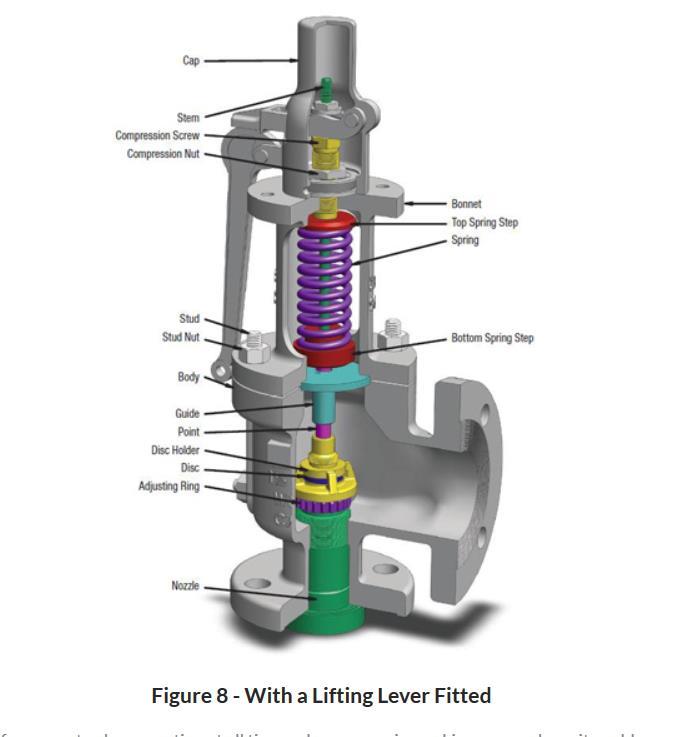

I found a covered device while looking through some photos and I'm having a difficult time pinpointing what exactly it is. There appears to be a handle and potentially a bleed port. Based off location, a blowdown would make sense, but I've never seen this sort of equipment for that process. Any guidance would be much appreciated.
Referenced equipment circled in images below:

It looks like a lift lever on an Open Yoke PRV. A lifting mechanism is used to test for correct valve operation at all times where corrosion, caking, or any deposit could prevent the opening operation. Foreign particles can lodge under the seat of the valve when it discharges. The lifting lever allows you to lift the valve and flush the obstruction.
http://www.iceweb.com.au/PressRelief/TechManual.pd...
RE: Unknown equipment at meter station
"It looks like a lift lever on an Open Yoke PRV." Except here there is no Outlet Nozzle.
