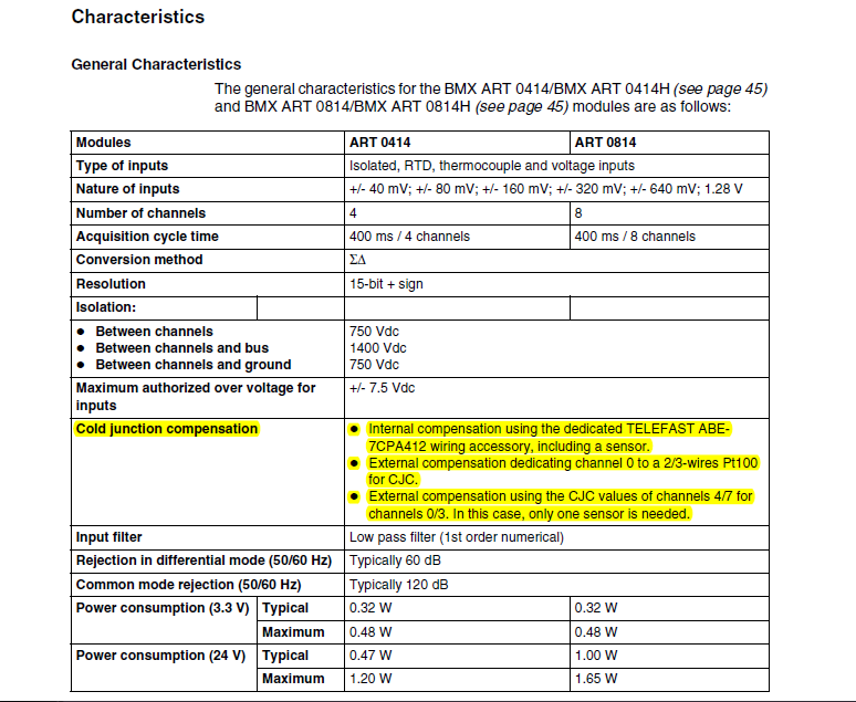

Good morning gentlemen,
Dan - I like the idea of the test and it is something I will be trying.
I do think that it will be necessary to provide external CJC as literally no where on this manual it suggests that internal CJC is already provided (without the additional accessory that is).
I have included an image of the manual that focuses on CJC.
Jericho
RE: Thermocouple Cold Junction Compensation Query
Thanks for the link to the manual.
Seeing is believing. I did not think that there was a commercial thermocouple AI card that did not have internal CJ as a standard feature in this day and age. Yet, here it is.
What a pain to not only have to supply a CJ sensor for each 4 channel card but to have to position the sensor for a decent CJ reading.
I'd probably opt for small diameter 2 wire Pt100's. The connections are so close to where the measurement needs to be made that the lead wire error will be insignificant.
And it appears that one gets to use all four input channels for thermocouples, when using the 2 wire RTD option (across EXO+ and EXO- in the graphic below).
