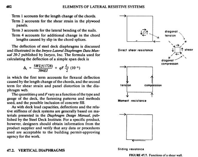

Hi folks,
I'm working on a project that has supporting calculations which reference an Inryco Lateral Diaphragm Data Manual 20-2. The manual would be of great use in evaluating the roof deck strength and how it was evaluated when it was constructed in the 1980s. Does anyone happen to have a copy of the manual that you could share?

Also this reference to 20-2 in an Ambrose book:

As you suspected, the 1092 report you attached was unfortunately not what I was looking for.
I did see the reference to the Inryko report in the USC textbook and actually talked to the textbook author, who is now a long retired professor. Unfortunately he was not able to help me.
I also talked to Inland building systems, who told me that they did not have legacy documents as the company had changed hands several times.
