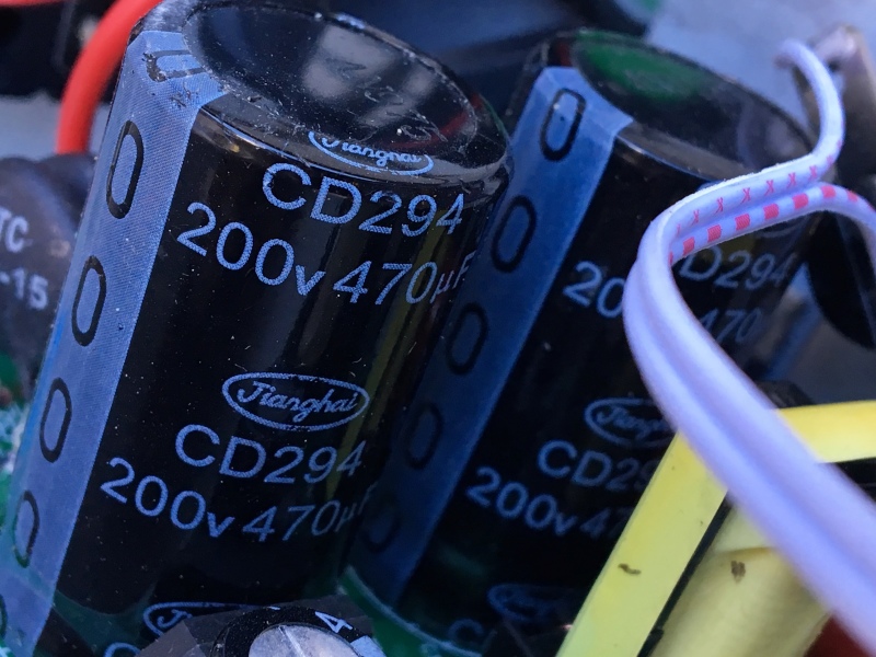

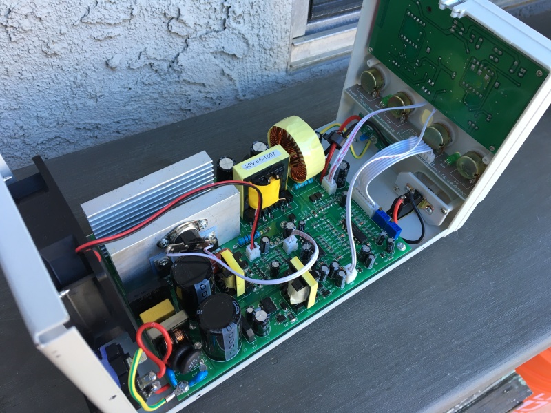

Does anyone know why both CV and CC LED's are sometimes lit when using my power supply? Scope shows odd waveform whenever this happens. Otherwise, flat line DC, no waveform, everything fine. It usually happens when current limiting knob is just starting to have an effect. Seems like the transition from CV mode to CC mode overlaps and causes a freak out. I can make it go away by over-turning the setting, and then dialing back down. I'm keeping the supply, so looking for a fix... adding a diode or resistor or a left-handed capacitor or some such ;)

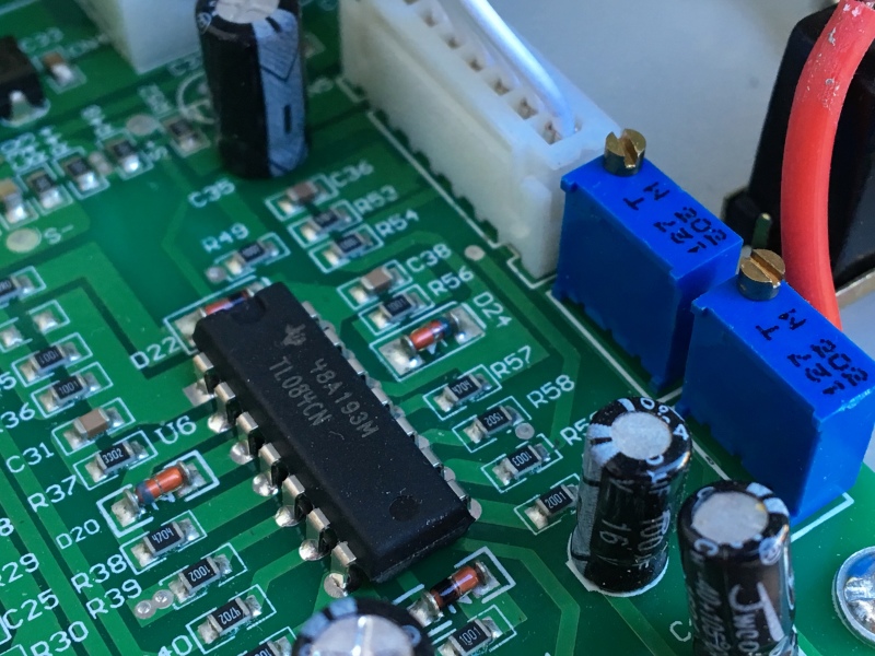

Thanks for your response. Yes it does have some good sized caps, couple of 1000uF and a couple 470uF. Actually there's an open spot on PCB to add a third 1000uF. I was thinking this might be a good idea, but after reading your reply maybe not. What about isolating, or separating the sensing circuit from the supply a bit, so it might not be so sensitive? Looks like the pertinent chip is a TL084CN Vcc'd at 24V. I'm currently attempting to reverse engineer the circuit and determine if anything deviates from TI recommendations. I don't know, seems like this op-amp is having trouble with a signal that's not real clean to begin with. Maybe a small cap added somewhere or a missing cap. Wish I was better at this. Thanks for your input, if all else fails, I'll just respect it's limitations and try another slightly more expensive PS. I do like that this one is a switching PS and has no huge transformer.

When both LEDs are lit at the same time, it indicates a huge problem since the op-amp is not supposed to be able to be in both states at the same time. So I am assuming, as was suggested by ScottyUK, that the Op-Amp control circuit is probably bouncing or oscillating between on/off or +/- or whatever. I am attempting to trace a few of the components in hopes of identifying some anomaly b y comparing to known op-amp data sheet schematics. At the moment I'm questioning the need for a 100uF cap in series with a 15K resistor between pins 10 & 11. And what role the 2 multi-turn pots play...perhaps a reference voltage needs adjusting. My goal is non-destructive experimentation and observation. Thinking about replacing the TL084 with an LT1359. :)

The operation of the LED and the mode of operation are not in directly connected to the operation of the power supply, close but not directly. Changing the op amp will make no difference. Given that it has an op amp, the voltage error and current are combined together using two diodes. When they get close, they interact. Before you get too bent out of shape over this issue, I suggest you hook up a FET or relay to a load resistor of an amp or more and switch the load on and off 50% duty cycle and see how that looks on your scope. Look at undershoot and overshoot on transitions. That is what I would be concerned about.

Thanks for your input, I'm gonna check a few caps today to verify no obvious bad ones, and if time permits, maybe give those 2 multi-turn pots next to the Op-Amp a couple spins in both directions and see what happens. (I'll note the resistance settings before hand of course) Will update with anything new.

Yea, I think I'm just gonna have to live with it until I can find a deal on a better PS. I have watched several YouTube demos on similar supplies and what I've noticed is that the CC and CV LEDs seem to lock in very quickly with virtually no overlap. Like a SPDT switch. You can have either A or B, but not Both. Anyway, at this point I'm not going to spend more time on it. I've tested nearly a dozen Caps and reflowed a few suspicious looking solder joints and no change so I'm putting it back together. I'll be careful not to let those limits overlap. Thanks to everyone that commented and offered suggestions, I appreciate your time! - Peace
