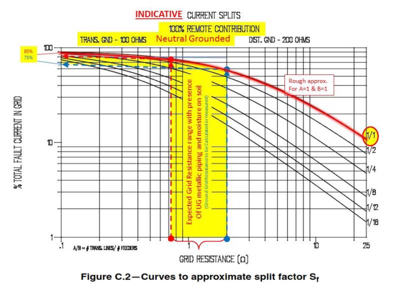

Yes, you would use Category A with a 25 kV ground fault. Treat the 25 kV line as a transmission line. It is the source of the fault current. The difference between a transmission line and a distribution line is that a transmission line is a source of fault current and the return current would flow in the transmission line shield wire back to the source. A distribution line neutral also will carry some of the return current, but it has to flow out of the neutral into pole grounds and through the earth to get to the fault current source. In your case, you would have no distribution lines.
I haven't used Annex C because my grounding analysis software (CDEGS) calculates the split. It looks like Table C.1 and Figures C.1-C.16 are alternative methods. Your case would be 1 transmission line, 0 distribution lines, but use the higher 100 ohm transmission ground impedance. It looks like IEEE screwed up the column headings in Table C.1. The last column should be Rtg=100; Rdg=200.

It is my understanding that when using the Annex C tables "distribution lines" are for lines with a multigrounded neutral conductor, whereas "transmission lines" are those with a shield wire - the main differences being the assumptions used for the conductor impedance, spacing between grounds, and the ground footing resistance. To some extent line length also plays a factor, although after a certain point this has a diminishing effect on the collapsed/driving point impedance. All of the assumptions used to create the graphs are pretty clearly stated in section C.1. It is likely they won't apply exactly to your system, although may (or may not) be useful for some initial guidance on the current split factor.
RE: Estimating Split Factor using Annex C in IEEE 80
I believe that the main difference between a transmission line and a distribution line with respect to current split is that:
  • The fault current returning in the transmission line shield wire has a metallic path all the way back to the source substation.
  • The fault current returning in the distribution line neutral has to flow from the neutral into multiple pole footings and then back through the earth to the ground grid of the source substation
The 25 kV line probably has an impedance and length closer to that assumed for a distribution line, but there is no way in Annex C to take that into account. Assuming a longer length than actual for the transmission line would probably be conservative, meaning less current would flow in the shield wire than calculated.

The prerequisite to use the graphic method to determine the split factor is that the system under consideration has to be reasonably similar to those covered by the graphic selected. Accurate result could be obtained by modeling the overhead neutral conductor in series with the underground cable shield wires, phase conductors, pole, etc. (For reference see Fig 32 of the IEEE Std 80-2000)
For illustration only, enclosed is a rough approximation of the split factor using a graphical method just with expected indicative high current split factor.
