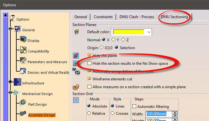

I had to delete my catsettings and now every time I make a section, after clicking ok it hides. I have to go to the tree and activate it
Before it stayed.
I checked the sectioning settings and also the options in the tree but I don't see how to keep them
Does anybody know how to keep it?

RE: Assembly design: sectioning hiding after closing the dialog window
Quote (you)
What do you mean be activate?
Eric N.
To show it,
After clicking ok on the sectioning dialogue windows it goes automatically to no show
Eric N.
yes!!
that's it
i missed that!
thank you very much
