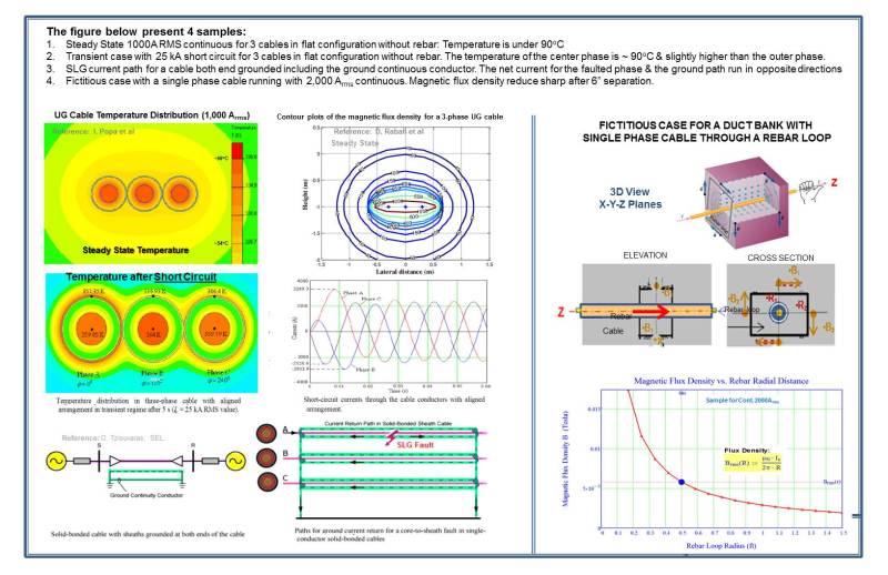

Hi 7ANOTE4, thanks for the reference provided. Unfortunately I believe that the table 4-7 of the IEEE Std. 142 is associated with concrete encased electrodes where the rebar will be part of the conducting element of the concrete/steel assembly. Also the Std. 142 refers below the table to white paper by Fagan and Lee associated with concrete-encased footing electrodes (see the link below).
For duct bank application, the reinforced rebar are not intended to carry current during a fault in the way is designed for the grounding electrode. The duct bank steel rebar will only carry inductive circulating current produced by the net current of a three phase circuit.
The largest net current is associated with an asymmetrical fault (Typ. SLG & LLG SC). The total current though the rebar loop is the vectorial sum of the phase conductor current and the current on the cable shield & continuous ground conductor, CGC (PEC grounded at both ends). Should be noted that fault current on the phase conductor and the ground/shield conductor’s travel in the opposite directions. Therefore, the net current is a fraction of the total fault current.
The magnetic effect on the rebar due distance to the net fault current will induce a small circulating current on the rebar and could be further reduced if there is enough separation, not closed loop, or none magnetic rebar material. In 5 cycle clearing time, the temperature does not reach critical values that compromise the duct bank integrity.
See the enclosed file with various samples that I hope helps to illustrate the steady state and transient condition during fault event.

7noter4, I'm glad that we reach a consensus in this important subject for UG application.
I am attaching the image below corresponding to the second link that cannot open. I hoping the illustration below will reinforce your conclusive remarks. Thanks again for help us to clarify this issue.

For the described case, the heat generated on reinforces concrete duct bank do not appear to be a major problem for this application.
