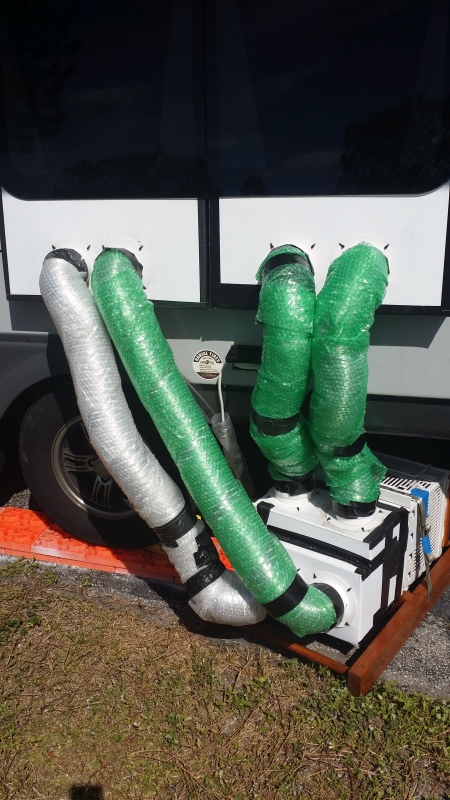

This may be of interest. The contraption in the photo cools my travel trailer using a small cheap window air conditioner, on a normal 15A circuit, as opposed to the roof unit, which draws somewhere upwards of 22A when starting. The various adapter boxes are made of Coroplast, folded to suit, with edges joined by staples and 1/2" square dowels, sealed with Gorilla Tape.
The Coroplast does not sweat, suggesting that its insulating properties may be sufficient for your purposes, even without the vacuum. Certainly a double layer would work for you, and the stuff is pretty cheap.
