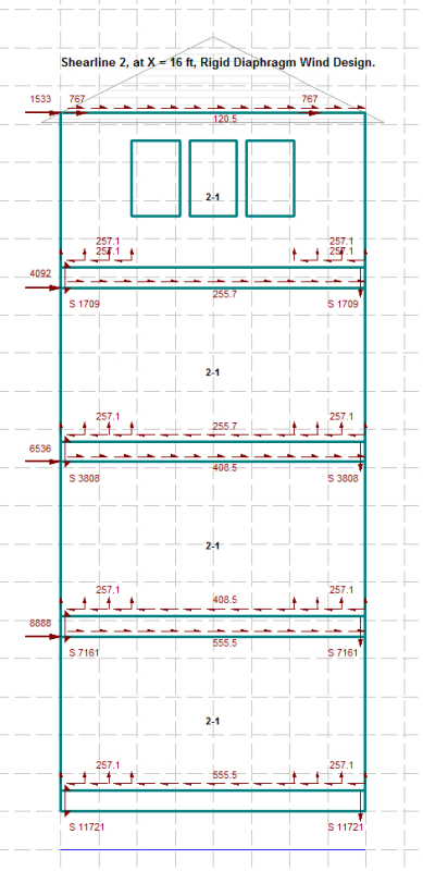

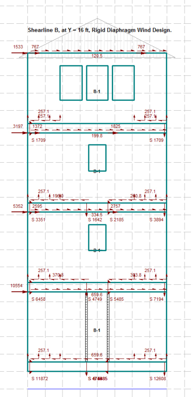

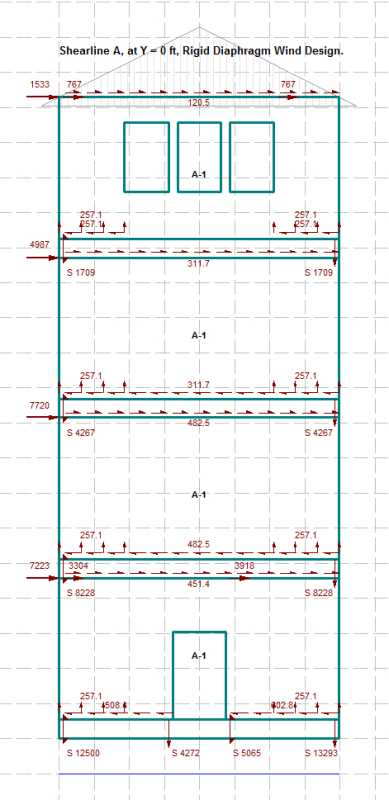

However, out of pure curiosity I threw it into my shearwall program just to get a better idea on what kind of numbers we are talking about. As I expected the wind loads far out govern the seismic. I got it to pass if I used 15/32" sheathing (6 edges,12 field) interior and exterior on level 1 and level 2 shearwalls.
If I was to frame this I would probably use 2x8 lumber on the 1st level, with 8x8 shearwall studs at the four corners and a (2) HDU14 holdowns at each corner, this is probably a bit overkill but I would rather be conservative on a structure that is sure to take a beating. The second level, I would use 2x6 lumber but use 12" o/c stud spacing. The shearwall studs at the corners would be 6x6 with (2) HDU11 holdowns at each corner. The third level I would use 2x6 studs at 16" o/c with 4x6 shearwall studs at the corners and (2) HDU8 holdowns. At the 4th level (2) 2x6 studs at the corners and (2) HDU2 holdowns.
I would probably also run interior shearwall sheathing 7/16" on level (3) just for good measure but the numbers show that one exterior sheathing should be sufficient.
My soil is quite expansive in my estimation (I'm not a geotech) so I would probably install 42"x42"x12" spread footings at each corner of the building, integrated with the 24x12 footing. The one thing I haven't checked is the total overturning of the structure.
On the lower windows and doors I would probably running some strapping for force transfer around those openings.
So yes, I think one could platform frame this thing and actually make it work. The only thing that I don't have a good handle on is the overall deflection of the structure, it probably does not comply with the ASCE7-10 in that regard. Take a look at the numbers below:
