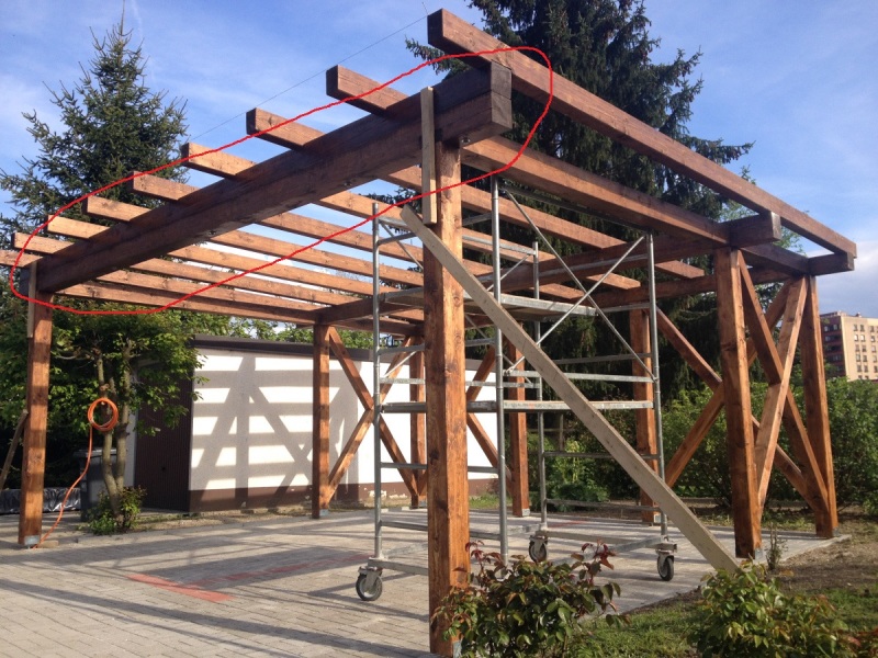

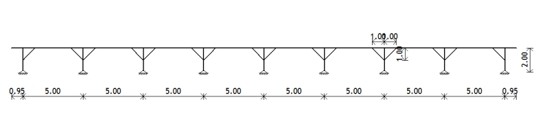

The load is not applied yet.
Problem is that contractors already has element 1: 20/28 cm but its not suffiecient material. They want to keep this element and add another on top of it (element 2).
The actual model is like this:
i was thinking something like this:

Can you put anoher element from the side where it is overstressed? You can glue and screw plywood on both sides of the beam.
RE: double wood beam - shear control?
Unfortunately I cant. Agreement was double wood beam and bolts only.

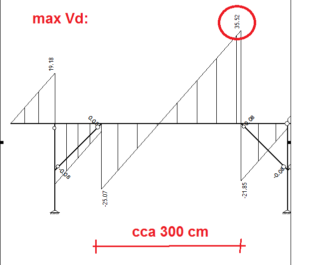

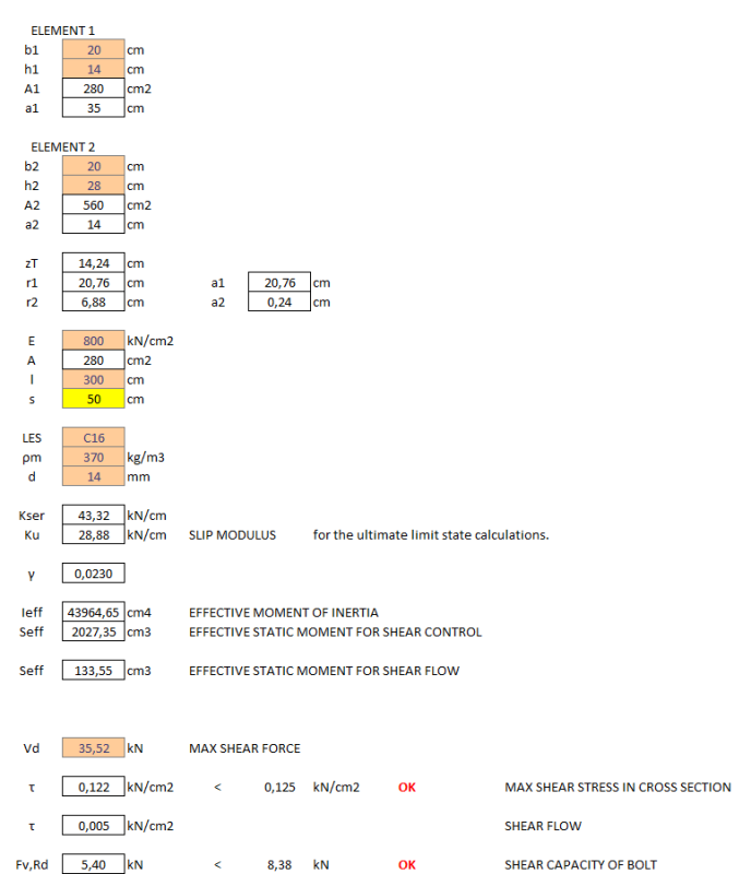

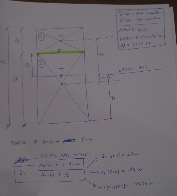

i made some calcualtion based on eurocode 5.
if this is right, it means that bolts dont contribute much!
gama = 1,0 means complete 100% connection between elements
gama = 0,0 means there is no connection
for bolts M14 (8.8) at 50 cm spacing I got gama = 0,023 which is almost zero, but enough for controls to be OK...
Bolts alone are pretty ineffective because they dont produce enough resistance for shear flow development... if i choose smaller spacings its still pretty ineffective.

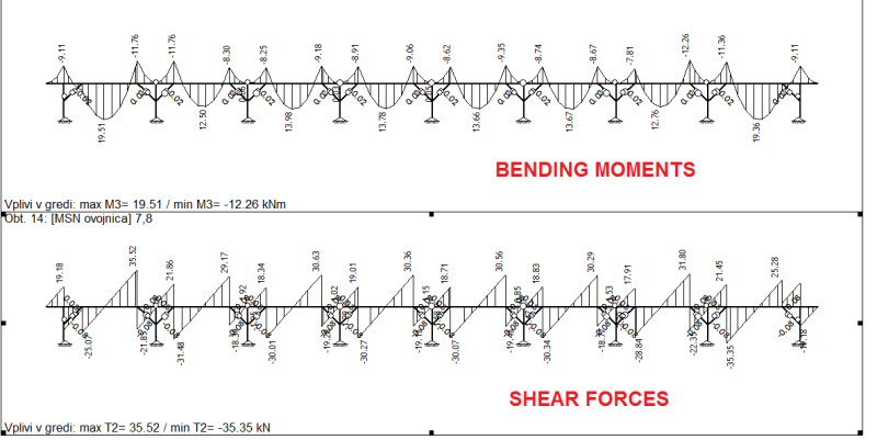

mats12,
You started out with 5 m simply supported beams. Your shear force diagram seems to be taking into account some form of continuity, but it is not clear which spans are loaded and which are not. In order to analyze the structure, you would need to know the stiffness of the columns. I don't believe your shear diagram is accurate.
It might be prudent to retain a structural engineer to analyze the structure properly and to make recommendations to the contractor.

There is a shear force diagram and bending moment diagram for the whole thing for those who are confused by picture posted above:

Will the structure as shown be exposed to the weather?
Epoxy and split ring connectors.
http://www.awc.org/pdf/codes-standards/publication...
Plus a bunch of bolts.
If there is no flashing cap on the top surface, lag screws from the bottom so the top surface remains intact.

mats12,
Your bending moment and shear diagrams are wrong. It appears to me that you have entered the wrong support conditions into your program.
BA
BAretired - I dont understand. What is wrong!? I think diagrams are pretty expected? Please elaborate!
I used pinned supports for timber columns (vertical and horizontal support + free rotation)

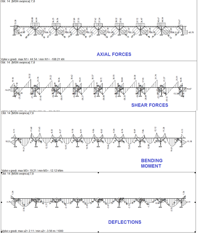

Based on the moment diagram, I'm seeing a beam splice at each post and posts that don't introduce much rotational stiffness (end span diagrams).
You appear to be treating the upper ends of the knee braces as hinged supports. They are hinged, but they are not hinged supports, i.e. the hinge can move vertically. When it does, it causes compression in the knee brace and moment in the column. With your shear diagram, the moment in the end columns would be very large.
What load are you assuming in your design? Are you considering the possibility of unbalanced live (snow) load?
BA
I think my supports are OK. In previous picture I show forces for beams ONLY.
Here are diagrams for all forces including columns. Also deflection diagram.
I think my model is alright. And yes, snow is considered.
I apologize. You appear to have considered the knee braces correctly in your analysis. The end columns have a moment of 10 or 11 kN-m which will require a fairly stocky section.

Hello, this is my first post here. If you want to add an additional beam on the top, I'd do that but instead of installing bolts vertically I would install them on an angle, see attached sketch.. I think that would take the shear stresses.. I am not much experienced so it's just a suggestion.
Heldbaum, that is what I would do with self-tapping screws - full thread. Besides gluing that is the most rigid connection, because you rely on screws in tension and not shear.
Also you could do this (tension+compression): Picture
