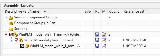

I have been searching the threads all day, and still haven't found a solution to my problem with reference sets.
My assembly problem is more complicated, but I have simplified it here: (NX10)
I have a part "A" with a crimped and uncrimped body in the part. I made 2 reference sets in the part named crimped and uncrimped. Each with the other body not shown.
In my first assembly "B", other parts are assembled with part "A", but no crimping is involved, so I use the uncrimped reference set in this assembly.
In the next higher assembly "C" which contains assembly "B", the parts are crimped. This is where I am thrown off - if I change the reference set in assembly "C",
it messes up the assembly "B". Is there a way to show different bodies of the same parts in different assemblies?
I understand reference sets were not intended to be made in assemblies, so I have avoided that. I have seen suggestions to use arrangements instead,
but as I understand arrangements control position and visibility of instances, not visibility of bodies. Any help would be appreciated.

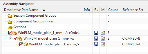

RE: NX Reference Sets - Again
Keep in mind that a reference set only works one level up...Which means it will only have effect in the assembly which holds the component.
So to get the result you want, you need to create the same ref sets again in assembly B.
  • Ref set Crimped shows component A with ref set Crimped
  • Ref set Uncrimped shows component A with ref set Uncrimped
I also always love the Statement "Ref sets are not meant to be used in Assemblies" So what are they meant to be used for then?
I must be missing something. I created a dummy scenario (see pic). If I create reference sets in assembly2, it won't let me pick the bodies to include/exclude.
I have 2 ref sets in PART1 (FORMED and UNFORMED). I set assembly1 to use UNFORMED. But I can't get assembly2 to show it formed.
This is a pretty common scenario - it shouldn't be this difficult, should it?
Holy cow, I just figured it out. You don't have to re-define the reference sets in each assembly (pick the bodies), you just have to have them named the same in each assembly (I assume they have to be named EXACTLY the same). I guess that is obvious to a long-time user. After I created the same named reference sets in each assembly, I could replace them in each assembly. Thanks for all of your help, these forums are so helpful, especially for us newbies. Now I have to apply this theory to my real parts and assemblies...

@Xwheelguy: Not sure what you mean, my first post does say that you can control visibility with arrangements. At this point that is one of the only things I am sure of.
I am in the process of pulling all of my formed bodies out of my parts and making them separate parts. But I will try and post some pics to explain:
The first pic shows parts before entering 2nd asm.
The 2nd pic shows sleeve (green) pulled back, and uncrimped parts ready to be crimped.
The 3rd pic shows the end result, with 4 parts formed, sleeve is sandwiched in the crimp.
