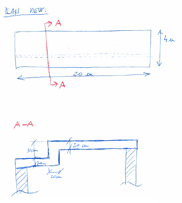

How do you guys design concrete slab like this? How to model it? What about reinforcement?
RE: Concrete slab in two levels - design/modeling?
There has been a couple of threads about this, but the consensus what you design the slab without
the step and detail the step "connection" so that moment can transfer though.
The step width (your is 20cm) should be at least twice the step height (30cm), in other words the step width should be 60cm.
Also take note the a step like this will create a slight increase in the deflection, just keep that in mind.

I dont know how to:
'detail the step "connection" so that moment can transfer through'
any suggestion?
Im confused - because of the geometry of the slab the load will transfer only in short direction (perpendicular to the step)... so the step (beam) actually dont help with bearing the plate. But it has to transfer moments (perpendicular to it) to the lower slab. Right?
It also bothers me becuase the step is near a support (concrete wall).

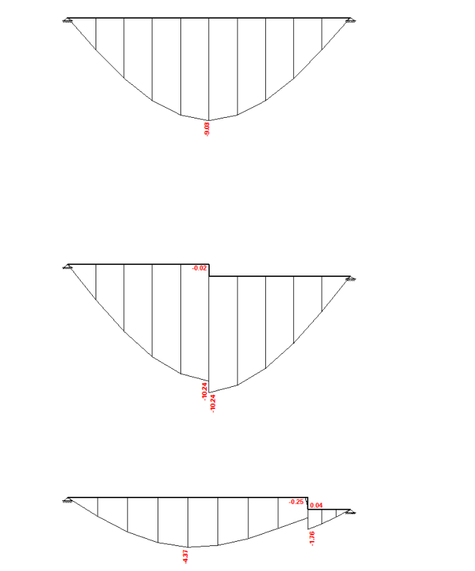

tNX, but im dealing with a slightly different problem - my step is near support.
That changes things drastically.

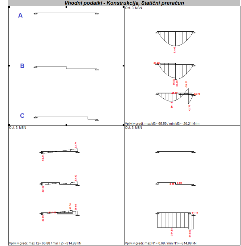

If the step is in the middle of a span, then I agree - moments, shear forces and deflections are very similar. But not in my case when step is near support:
DEFLECTION:
MOMENTS, SHEAR and AXIAL FROCES:
Looks like step near support has good effect on deflection and lowering moments, but axial forces are huge.

Quote (Steyn)
I've always seen this as twice the thicker slab depth (upper/lower). So 40 cm my way. Which is not to say that there's anything wrong with Steyn's method.
Quote (OP)
any suggestion?
The thread that Steyn linked for you has a strut and tie model of the situation that can guide your detailing. If that's insufficient for you needs, let us know and we can provide more detail.
Quote (OP)
Exactly right.
Quote (OP)
It's the same problem in my book. Just less moment and less impact on deflection which is nice.
Quote (OP)
This is because you've pinned both ends of the slab against lateral translation. Are you sure that's appropriate in your case? I would think not based on your sketch. There's almost some unintended source of restraint but that is rarely considered by designers in these situations.
