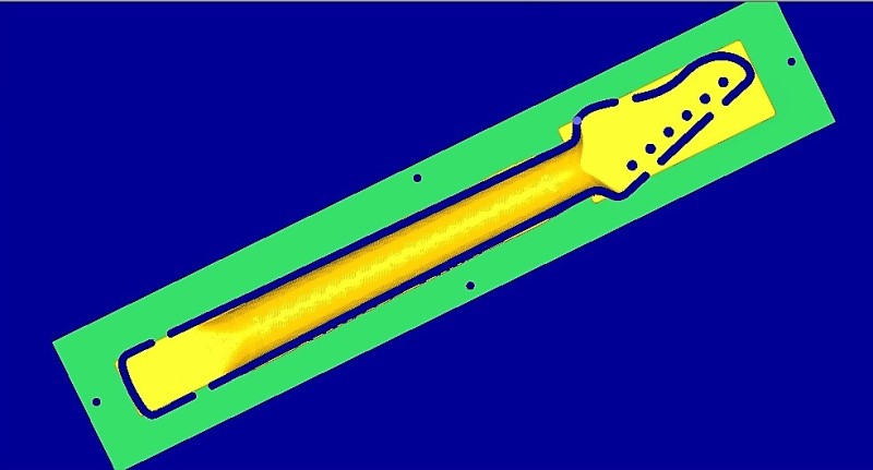

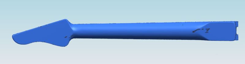

Hi everyone, I had a guitar neck digitally scanned for my daughters school project, to machine it on a router, but no matter what software I try, it comes out as patches of surfaces. Is there a way to make it just one solid or surface as if it was extruded from a 2d sketch?. Thank you all, any help would be great. stl and bad model image attached.
RE: Help with an stl file reverse engineering into a solid or surface
If all you're after is the 2D outline to then extrude, then in my opinion it would be easier to use and HQ image and either vectorize it with another program or just sketch over the top after importing the image into NX.
I like using Inkscape to vectorize (see https://vimeo.com/83654051 on how I do it).
Otherwise, cut sections through the STL and use that as the basis for what you're after.

Hi, all I really need is the neck radius and head and heel transition to be one surface so I can flow line mill it.

Have you tried using "Rapid Surface", in the Reverse Engineering tab (NX9+)

Stl files will not appear in the part navigator unless you set the navigator to "history free".
It should be visible in the graphics.
Stl files will not create solids but " a faceted body". - Which you can section etc.
If you have NX11 you should be able to do some solid modeling operations on that faceted body.
( NX 10 & earlier cannot do solid operations on facets.)

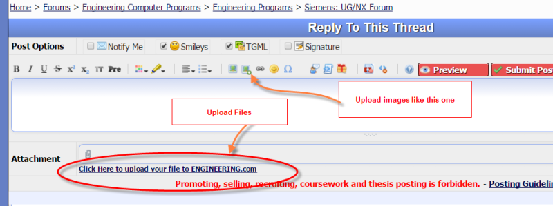

I'm not sure how to get a zip file on here, it works on cnczone.com.

All I need is one solid or one surface to machine just the neck radius areas and transitions, but currently full of facets.
Dave, this might work perfect, pushing it around, trying to get it normal to the original surface, otherwise, this is exactly what I need. Thank you for the help.

Thank you for the help guys, I'm very close on this now, just have one area close to the heel that needs attention. This is from what Gunman sent me.

They way I did it, you pick the STL file, and then draw 4 splines on the part, think of it like a "square", and it will create a sheet. You can adjust the degree, and a couple other things, depending on the surface quality you want. So, I did this in various places, and then filled in the gaps with other tools.

It depends on the scan quality which way I start building the surfaces. I create several of them too when the quality is too poor to create everything or most at once.
I can share the NX file, note that I've done it with 11.0.1. I share couple pictures of the surface pattern to get the idea what I was doing. I don't know what is the best way to create the pattern, this way is what I've learnt with trial and error.. Basically loose pattern/web where high resolution is not needed and thicker web where resolution is needed like in the variable radius areas in this model. I would be more than happy to receive any tips or better ways to use Rapid Surfacing also.
