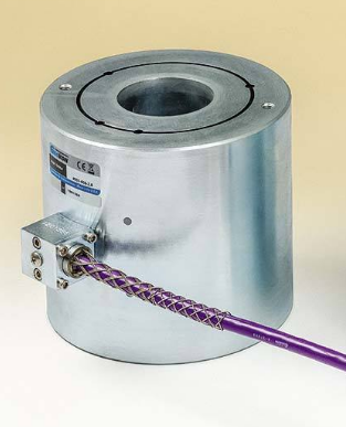

With regards load cells to monitor the dead-end and live-end PT forces (and hence determine losses between each end) the typical load cell is annular in shape, with different center hole diameter available from 25mm to 250mm, or larger.
With a flat-type anchorage, and its unique anchor-head shape, you maybe best to use a small diameter annular load cell and monitor one (1) strand only of the tendon, and use a barrel-chuck for the selected strand that is monitored (preferably the center strand).

If you want some info on load cells this manufacturer has good products, including very economical data loggers: Link

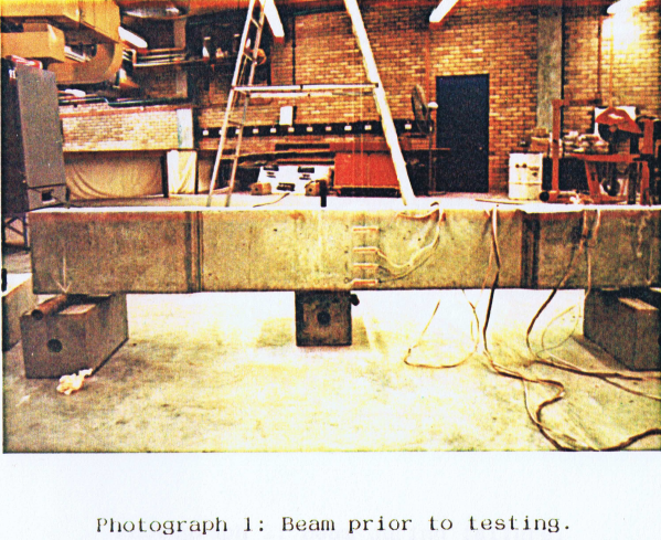

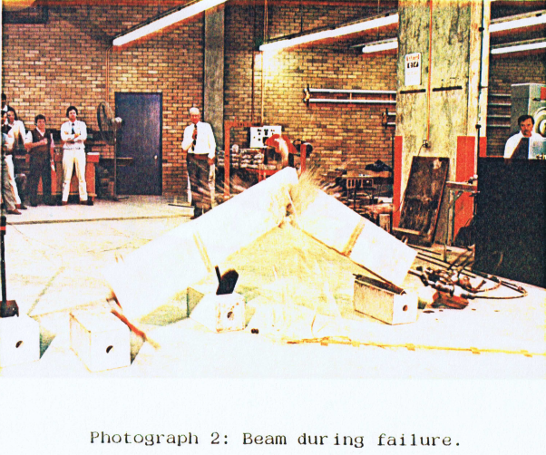

You may be interested (maybe not?) but I dug out my 30 year old undergrad work. However, of no real relevance to your proposed testing. We used a 1 x 15.2mm dia. strand tendon (not grouted) that was continuously stressed until failure occurred via compression failure at midspan. Failure occurred at a prestressing force of 155 kN - in a violent manner that we captured via a 'trip toggle' to a camera away from the danger zone.

Yes, a parabolic profile, with zero end eccentricities.
We were verifying the calculated 'strength at transfer' of prestressed elements so that entailed increasing the applied prestress jacking force in the strand tendon until the concrete compression strength capacity (not stress) was exceeded at the bottom section of the beam at midspan, closest to the maximum drape.
We purposely narrowed the beam section at midspan to only 95mm in width to make sure that as we increased the jacking force to maintain our desired compression failure, we did not get close to the tensile breaking capacity of the 15.2mm strand.
If we had of used a wider section, or stronger concrete, 1 x 15.2mm strand would not have had enough tensile capacity to achieve our objective mode of failure.
