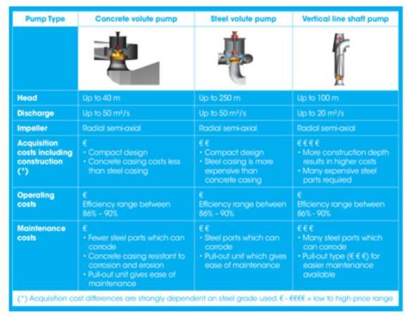

Is Concrete Volute Pump better in terms of cost of civil works required to install it? Is its pumping station structure smaller in dimensions and specially depth?
Somebody told me that it is more cost effective than line shaft VT pumps.
On the other hand, I need some suggestions to make me avoid constructing costly seawater pumping station. I will be happy if there is a design doesn't need breakwater. The sea water pumping station is of 100,000 m3/hr capacity. It can be expanded to 400,000 m3/hr in the future.

As the chart below notes, concrete volute pumps have an advantage in being corrosion resistant.
The concrete volute pump is probably more cost effective than a line shaft VT pump, byt has an upper limit on the discharge head.
