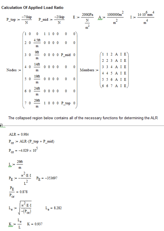

To my knowledge, none of the common software packages would allow you to properly do simple, linear elastic model, code checks on a column of this sort without some massaging. The only way that I can think of to fudge it would be to calculate an equivalent K value by hand and then manually input that into the design checks. I've got a MathCAD spreadsheet that I set up to calculate the equivalent K value. If you're interested, and have MathCAD yourself (v15), I can share that. It's not well documented, however, and relies on a bunch of matrix/eigenvalue voodoo. I'm not sure that you'd ever be willing to trust it for your own, real world work.

My widget gives KL = 0.94 X 29 ft. So about a 12% increase in axial capacity. Pretty modest.

KootK thank you for the insight, I followed through with the beam column calculations and everything was good and used your matrix in calculating a more precise K value which as you mentioned slightly did increase the axial capacity.
