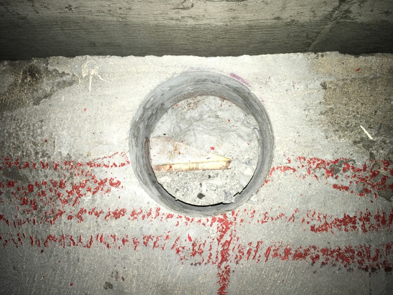

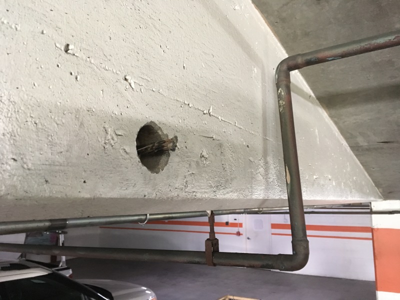

Here is a dead-end anchorage that was cored last month - drilled half-depth through the monostrand anchorage, one wedge, and the 7-wire strand released suddenly. Strand projected from the opposing live-end by about 3". Tendon was 50' long.
