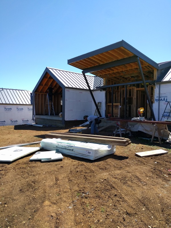

Not a screened in porch but common vaulted gable condition we run into.
