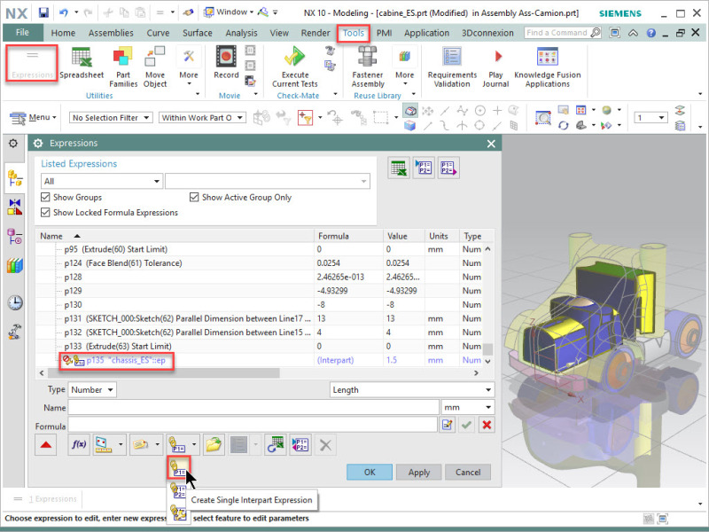

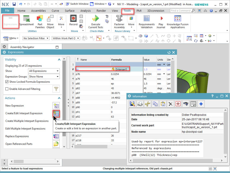

RE: Expresseion
You need to use interpart expression
The syntaxe is in core_side.prt
blend=1.5*cavity_side.prt::blend
Regards
Didier Psaltopoulos
http://www.psi-cad.fr
RE: Expresseion
small mistake, the syntax is:
blend=1.5*"cavity_side"::blend
NX10 menu
NX11 menu
