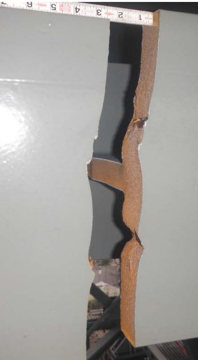

RE: PA-NJ Turnpike Bridge Closed due to Fractured Steel Truss
JAE:
I see what appears to be two horizontal pins in the end of the broken face. each at the third points and centered.
Seems strange...

I may be all wet but it looks to like the inside face of the crack is rusted. That would indicate that the crack had been present for some time.
Shear failure in a compression member resulting in brittle fracture from cyclical loading at plug weld locations, welding that crystalized and strain hardened the local mild steel matrix.

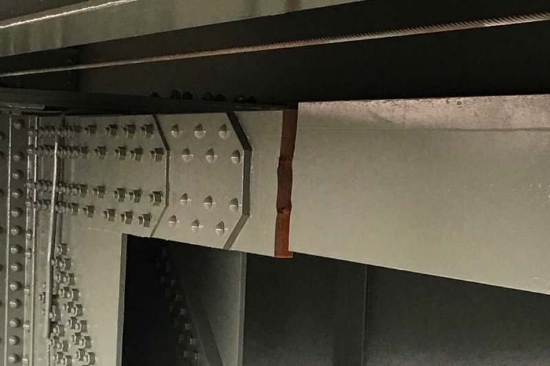

Freshly painted, so I think the crack is new. And it looks like a tension member, continuous top chord near support. The member is, I think, a wide flange, and we see the outside flange. Maybe all the way through, but not conclusive from the photo.

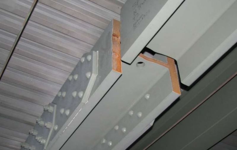

Here's another overall photo of the fractured wide flange (W14 I think)

Here's a couple of photos from bridgebuster's linked report and it included the statement:
Based on the length of time from when the failure is presumed to have occurred to when it was discovered, and the bridge’s continued performance under full live load during that period, it is unlikely that the bridge was in immediate jeopardy of loss of stability. It is clear that the fractured member was carrying no load, and the structure had redistributed the load to stable load paths. It is unlikely that the load paths would suddenly change such that the fractured member would again be relied upon for any load carrying capacity, without restoring the original truss geometry. However, the immediate splice plate repair was necessary to provide the owners and consultants with a level of comfort with the safety of workers accessing the bridge.

That is a brittle fracture--no shear lips present at the fracture periphery. I bet it made a pretty good bang when it went.

Looks to me that the hole is just for drainage. Fracture appears to be not related to it.
Amazing how straight the break is!

really surprised at the lack of fatigue striations and the brittle fracture
Sawbux,
The holes referred to are the weld filled holes in the flange of the chord member, not the one that is open in the web.

Or, each particular portion of that particular member comprising an uncontrolled and undocumented plug weld and associated HAZ comprise an alloy puddle of uncontrolled and uneven composition, some of which may be cold short, i.e., brittle at the temperatures encountered over the river on the day the big bang was heard.
... Okay, I'm not completely happy with that above, so I'll try again:
Each of the plug welds was not documented, and likely not controlled wrt to electrode selection other than using what might have been available in the shop on very short notice without leaving a paper trail. The remainder of the bridge clearly has a DBT low enough to have survived a fair number of NJ/PA winters, but the plug welds in the failed member presumably have a DBT a bit higher than would be suitable.
If a brittle fracture starts in a localized area like that, will it be stopped when it propagates into a less brittle portion of the same member? Would the member have failed if there were only one mis-drilled hole? Should there be some sort of transition visible in the fracture surface as a fracture that started in brittle material reaches slightly less brittle material?
